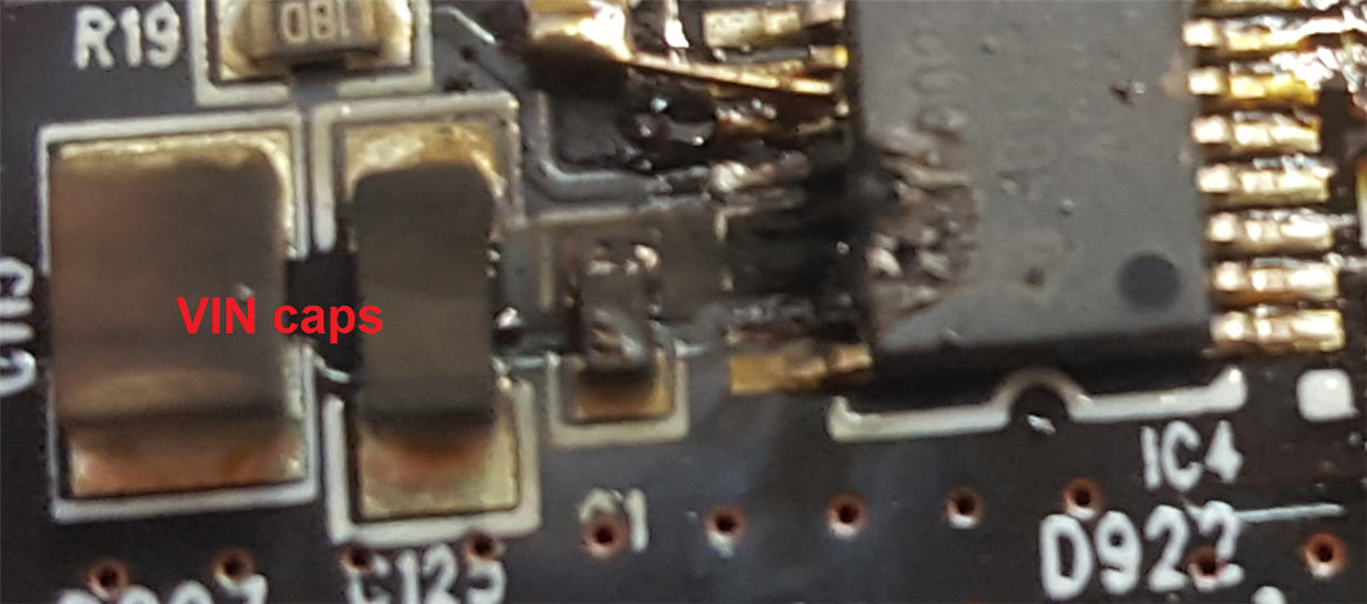

Additionally, we had one chip destroyed probably because thermal shutdown is not working properly. The input voltage was set to 56V, with the switching frequency (deliberately increased)  540kHz (82k resistor) and output voltage 4.2V. After approximately 5 minutes chip just burst (you can see it on photo) without going to thermal shutdown!
Burst chip
  • It looks like you have two issues.  Regarding the TSD, how did you measure the temperature ? Where is the heat-sink you mention ?
    It looks like an over-voltage event in you photo.  Be sure that the input voltage does not exceed the ratings, even for a transient.

    2.  We are not sure it is overvoltage, when max. VIN that our laboratory power supply can give is 56V . There is no ringing on SW pin or VIN pin!) Maybe this is due the Ton and Toff parameters of internal transistors, but as we said before Webench tool is claiming that everything (fsw, VIN and VOUT) is inside specs. The applied load was 2A (loaded with LEDs and drivers!).

  • It is possible that the device will not provide full load at at input of 56V at high ambient temperature.  In that case the junction will exceed the TSD threshold
    and the device will cycle on and off.  What is you ambient for this test?
    Regarding the damage, were there any transients during the test ?? Such as a load or EN cycle ?.  What was the ambient for this test ?
