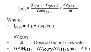

We would like to confirm about soft start time(tss).
[Q1]
What parameter is "20.6 * 10^4"?
I would like to know the calculating formula of this parameter.
[Q2]
I was not able to calculate as follows.
Please tell me if I make a mistake.
[My result]
-tss=20.6 * 10^4 * 12 * (1 + 0.07)=2645040s (The accounts don’t agree)
-tss=20.6 * 10^4 * 12 * (1*10^-9 + 0.07)=173040.0025s  (The accounts don’t agree)

  • Hi Vishal-san,
    I believe that “20.6 * 10^-2” is *10^-8”.
    Because, I understand that this value is “I(ss)/Gain(ss)=(1*10^-6)/4.85=20.6 *10^-8”.
    If no, could you please let us know the calculation method of this value?
    And, according to your calculation tool, tss is ((Cdvdt_ext+0.07)*Vcc_max)/(I_dvdt*Gain_dvdt).
    So, if Css (Cdvdt)=1nF, tss=4077669.961s.
    [My result]
    Tss=(((1*10^-9)+0.07)*12) / (20.6*10^-8)=4077669.961s
    Is my understanding correct?

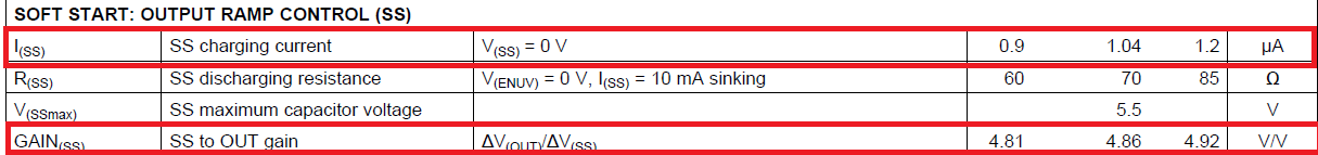

    I would like to know about calculation method of “20.6*10^4”.
    Because, our customer would like to include the variability of this value in a calculating formula.
    If 20.6*10^4(typ) is the correct “I(ss)/Gain(ss)”,
    -Min value is I(ss)(max) / Gain(ss)(min)=1.2/4.81=24.95*10^4.
    -Max value is I(ss)(min) / Gain(ss)(max)=0.9/4.92=18.29*10^4.
    Kanemaru
  • Kanemaru-san,
    1/(Iss*GAINss) = 20.6*10^4
    So, min value is = 1(Iss-max * GAINss-max) = 1/(1.2u*4.92) = 16.94*10^4
    max value is = 1/(Iss-min * GAINss-min) = 1/(0.9u*4.81) = 23.1*10^4
    The calculator also shows tolerances in column F.
    Tolerance
    CSS The external capacitor connecetd across SS pin 1.0 nF 10.0%
    Tchg_SS Charging time set 2.57 ms 18.3%
    regards,
    -vishal
