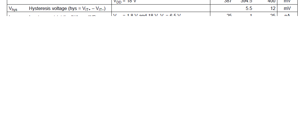

Question 2:
The min value of Vhys isn't indicated on the datasheet.
Please tell me the min value.
Thanks, Masami M.

  • Hi Masami,
    1: The accuracy of the thresholds is defined in the Electrical Characteristic table:
    As mentioned on page 11 of the datasheet in describing how to select the resistor divider, the total resistance in the divider should be chosen so that the divider current is 100x higher than the input current.
    2: Figure 5 demonstrates how hysteresis behaves over temperature and Vdd.

    Question 2:
    It's the minimum value of
    "hys = Vit+ - Vit-"
    that the customer wants to know.
    The minimum value isn't indicated on "7.5 Electrical Characteristics".
     Thanks, Masami M.

  • Masami-san,
    In order to ensure accuracy, the divider current needs to be 100x or greater the sense pin current. This is detailed in Section 9.2.2.1 of the datasheet.
    We also have an application note ( www.ti.com/.../slva450a.pdf ) that describes this process for selecting resistor dividers.
    You will not get a negative hysteresis if you set the resistor divider to be 100x or greater than the sense pin current.
