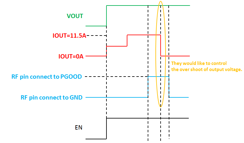

Our customer would like to change from “Auto-skip” to “Forced CCM” in operation.
Because, they would like to control the over shoot of output voltage when the output current change form 11.5A to 0A.
Could you please let us know if you have any concern?
