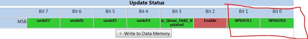

  • Hi Sorin,
    Looking at your Update Status, I see that bits 0 and 1 are not set. This means that your gauge has not completed a successful learning cycle and has not updated Qmax and the resistance tables.
    How did you do your charge/discharge cycles?
    Please complete a learning cycle and see if you are still having issues.
    Justin

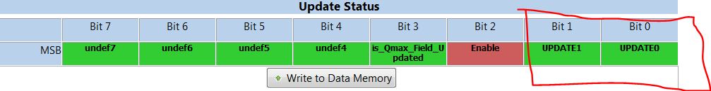

  • Hi Justin,
    After a number of failed tries to complete the learning cycle(following all the instructions on the app note), I decided to upgrade the firmware to R1.
    So, I upgraded to R1, I found and loaded the exact cell chemistry in your data base, I changed the flash values to accommodate our application and I tried the learning cycle again. Now, after I finished the "charging part", the update status jumped directly to 2 (6 if you consider GaugeEn bit). The app says that the status should change to 1 and only after discharge would change to 2.
    Other than that, everything looks good so far. I also recorded the registers during the process. Can you please take a look at the package that I send and let me know if everything is OK?

  • Hi Sorin,
    I noticed in your first gg file (before the learning cycle) your resistance tables have already been updated, so this is why the update status will change to 06. This does not mean that the gauge is good to go, and you still haven't completed a successful learning cycle.
    Can you please flash the gauge with a new .srec (-R1 is fine) and load your ChemID and configurations? Then create a golden file at this point.
    Now after doing the above, retry the learning cycle capturing the same files you gave me in your previous post.
    This is what should happen:
    Discharge completely, relax for 5 hours (update status ->04), charge to full, relax for 2 hours (update status ->05), discharge to empty , relax 5 hours (update status ->06)
    Also for small quantity production, you can use the .srec to program the devices.
    Justin
