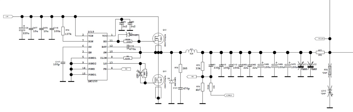

We have problem with unstable frequency on SW pin (please, see attached video).
On one large PCB (333mmx333mm) are 3 identical power supply and all have same problem with frequency instability.
Cff do not have any influence on instability. I tried values from 100pF to 1n (calculation says 255pF, populated 330p). Nothing happens (not even worse).
Power supply setup:
  • Vin=18V,
  • Vout=3V to 5V (PWM regulated from uC)
  • max current up to 5A,
  • 4L PCB,
  • C1 and C2 are populated (tantalum capacitor 330uF)
Schematic:
 Video file:

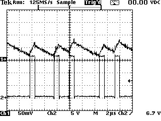

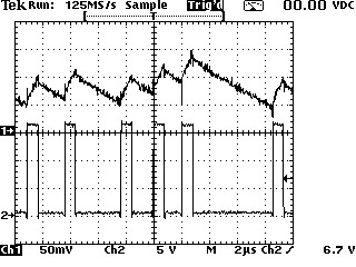

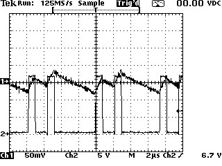

  • Hi
    I made plot of inductor current with SW pin. To do that resistor 25mR (shunt) was soldered in serial with inductor. One probe (CH1) measure voltage across that shunt, and another (CH2) SW pin. Oscilloscope (THS730A) have 2 isolated channels .
    This power supply is the worsted (with most frequency instability).
    Input voltage supply: 18V
    Output voltage: 3.7V
    load -> 628mA
    load-> 2.5A
    load -> 4.2A
    Video file showes instability on three loads (600mA, 2.5A and 4.2A):

  • Hi Kreso,
    Because the LM3150 is a Constant On Time controller, the converter's behavior is close to that of a hysteretic system and so can be subject to some frequency instability if the signal at the FB pin has low ripple since the next cycle will be triggered only when the FB voltage falls below the reference and not due to a fixed oscillator.
    Frequency instability is indesirable but it should not be an issue for the converter or the FETs survival as long as the overall averaged frequency is reasonable (for switching losses considerations).
    One way to remediate the instability, beyond increasing the actual output voltage ripple, would be to inject a AC signal at the FB pin sensed at the inductor level.
    The following article details the various compensation solutions for COT to address this type of issue:
    http://www.wirelessdesignmag.com/article/2014/07/simplifying-wide-input-voltage-dc-dc-converter-design-cot-topology
    You might want to try the scheme shown in Fig.8 of that article.
    I hope this helps,
    Florent Boico
  • Thank you for reply. It could be that the ripple on fb pin is to low. What is the mimimum peak to peak voltage on fb pin? I have 50mV.....as you can see from oscilloscope plots.
