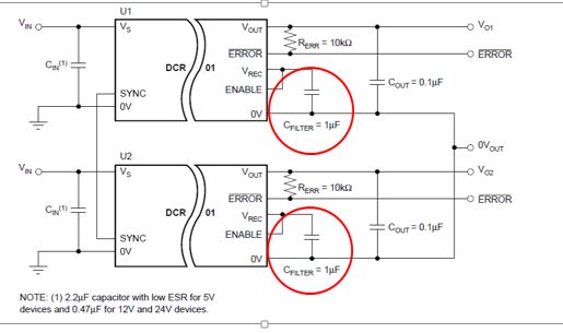

Hi Sir/Mdm,
For Texas Instrument DCR012405U Regulated DC/DC Converters, what is the recommended Cfilter for the rectified (Vrec) output?
Any particular MPN, type, size, besides the recommended capacitance?
Regard's
Jason
  • Vrec Cfilter required filter  capacitor type , value/  is a 1µF ceramic capacitor. The capacitor body size can be 0805 or 1206  16 volt rating . Ceramic capacitor tolerance recommended is X5R. Ceramic capacitors have a very low ESR ( equivalent Series Resistance ) at these switching frequencies of  2-10milliohms.
    1µF ceramic capacitors are very common and available from numerous distributors or vendors.
    Tom

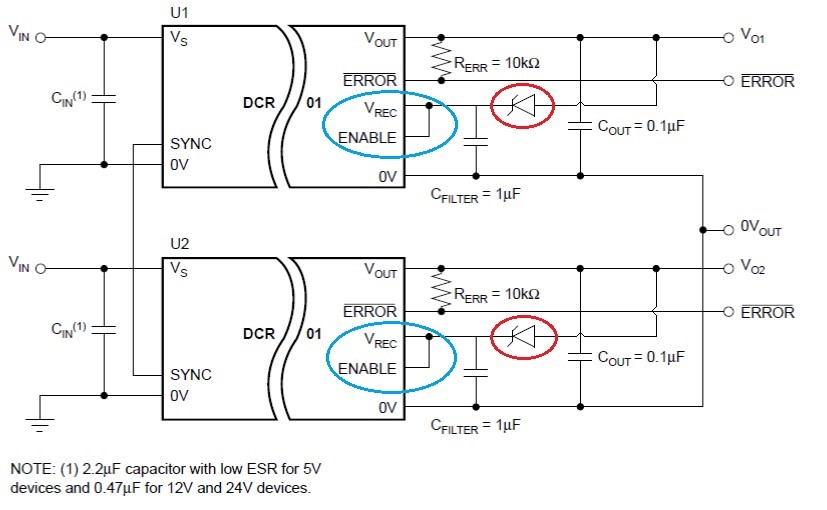

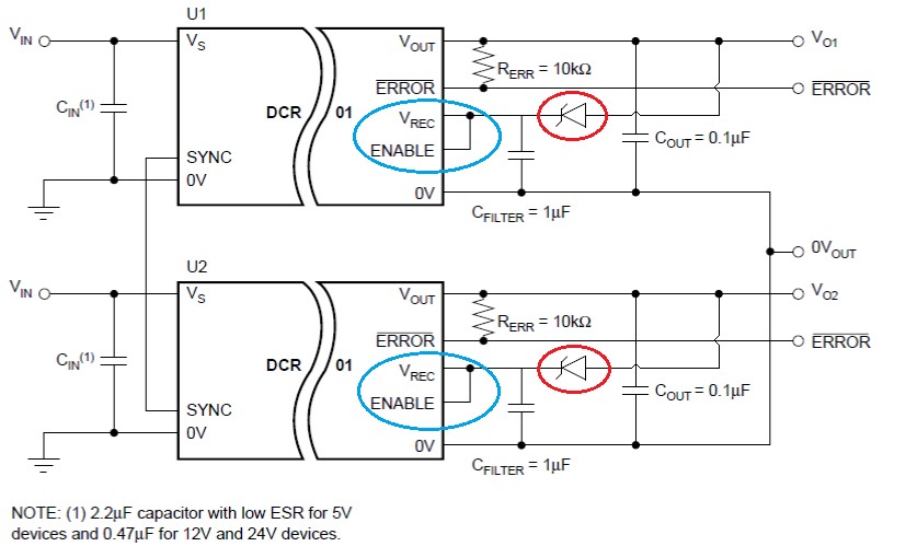

  • Hi Tom,
    We need these information to ensure reliability in any possible failure mode.
    1. Is there a need for additional protection for the LDO Vds from excessive voltage and negative bias - Vrec and Vout (Vds of the LDO regulator transistor)?
    1.1 Estimating zener clamping at about 12V, given typical is 9V, sufficient?
    1.2 What is the maximum negative bias tolerable, estimating a zener Vf of 0.8-1V, sufficient?
    2. Is there a need for additional protection for Enable from voltage transient/spike (during power up, between Vrec and 0Vout) given Enable is connected to Vrec?
    2.1 Is Enable a logic gate or does it power vref/error amp/ etc etc or both?
    Regarding:
    “2.     Can you tell us what is the Max Vpp of Vrec to 0vout (without filtering)?
    Ans: Typical P-P Square wave pulse is about 20V AC  P-P with no Vrec 1uF ceramic capacitor.”
    Thus, the typical voltage that will be seen at Vrec to 0vout after full wave rectification will be about 10VDC (assuming no switching loss) with minor square wave oscillation. Is this correct?
  • Jason:
    The DCR012405 or  linear regulator (LDO) does no have over-voltage protection. The LDO does not have negative voltage protection.  DCR012405  absolute maximum input voltage is 29V.  If there are any transients above this limit, a transient suppressor is required on the input bus.
