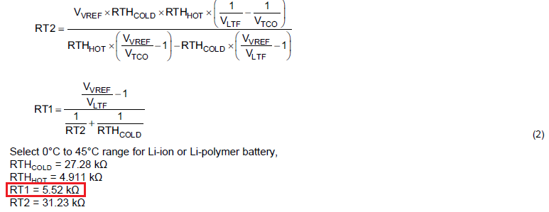

The datasheet of bq24292i shows the following calculating formula.
(Page.20)
I could calculate RT2 for 31.23kΩ, however I calculated RT1 for 5.25kΩ although datasheet shows 5.52kΩ.
Is it typo of the datasheet?
I adopt the following typical value to calculate.
- Vvref= 6V
- Vltf= 4.41V (73.5%)
- Vtco= 2.682V (44.7%)
