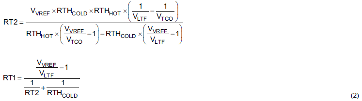

My customer considers to use TSM1A103F34D1(NTC thermister) with bq24292i.
http://www.teamyoung.com.tw/uploads/files/ecffdb15049fbb8a1d4cde22455c9f2b.pdf
Could we also use the following formula to decide the values of RT1 and RT2?
(datasheet page.20)
I believe it, but would like to confirm just in case.
