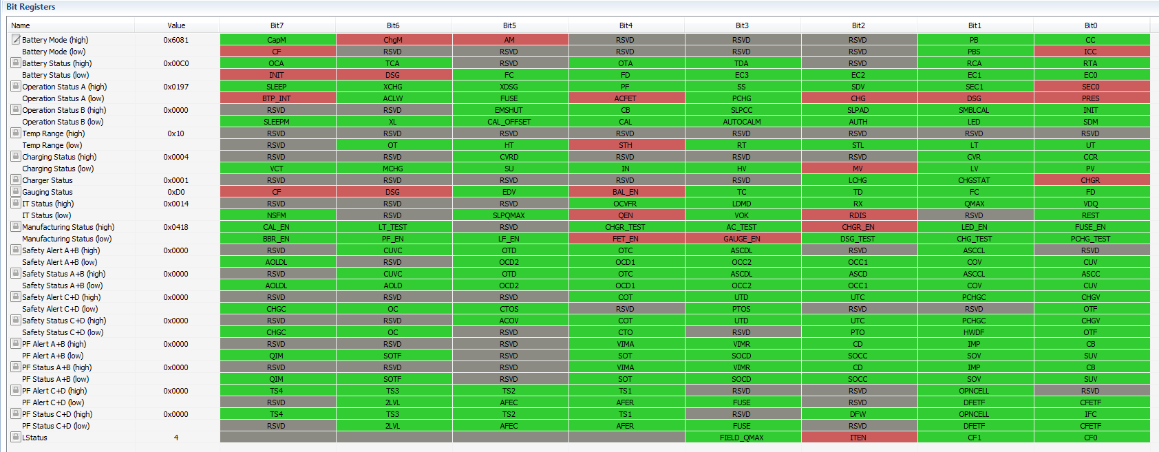

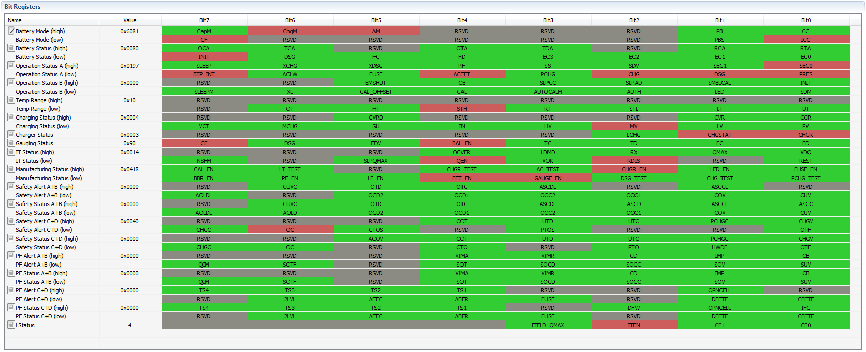

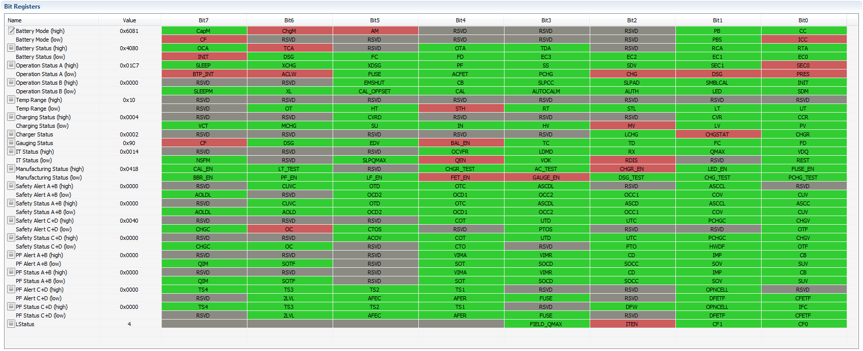

    With batteries installed (4x18650) both CHG and DSC FET's remain OFF. They turn on when the DC adapter voltage is applied. And, when the DC adapter voltage is removed, the FET's stay ON. Is there a means to have these FET's ON when batteries alone are installed?
  • When you were running off of the batteries, was the device running an communicating or was it in shutdown? You have to apply a charging voltage to wake-up the device and it should turn the FETs on as long as the FET_EN is set and PRES is lit. The charging voltage is only required to wake-up the device and it should run off of the cells after that. If you can send a screenshot of the bqStudio registers screen, then I may see another problem that is keeping the FETs off.
  • The CHG and DSG fets only turn on when the charger is connected first.  Once I do this, and turn on the batteries (installed switch at fuse), they stay on even when the charger is disconnected.  Ideally, I want them to turn on when the batteries are installed.  However, there may be some utility it requiring a charger connection when batteries are replaced in the field.
    I can get screen shots starting with charger only as just batteries does nothing (although I see BAT has battery voltage DC on it)
    1. Charger no battery:
    Charger with battery:
    Battery with charger disconnected:
