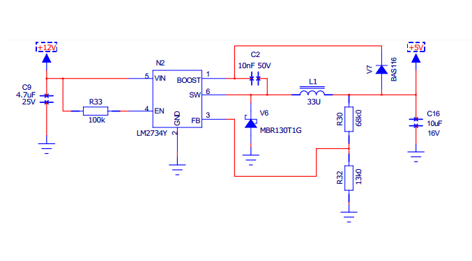

I was wondering what could be the maximum value for the Cboost when using LM2734Y and if using a 100n capacitor would introduce any major issue.

Thanks for your answer. No, I am not using the EVM. The reson for my question is that, in my circuit with an input between 12-6.4v and 5v out, when the input voltage goes below 6.8v the circuit starts giving a high frequency buzz sound. I have tried a cople of things and found out that with Cboost changed to higher value I can achieve better result. I used up to 1u and could observe a stable 5v and no buzzing. However I could only see 10n recommended value for this throuhgh out the entire datasheet...
