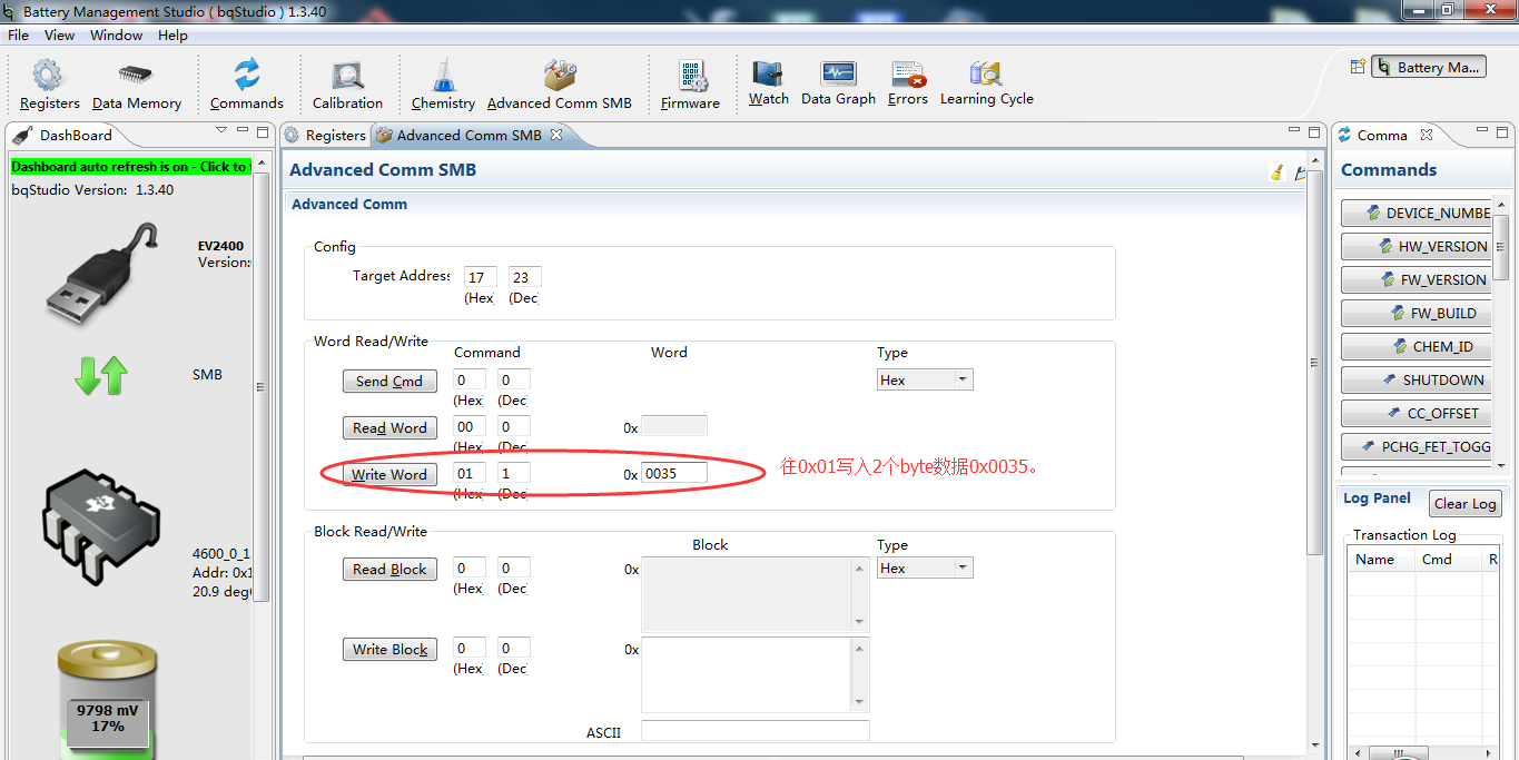

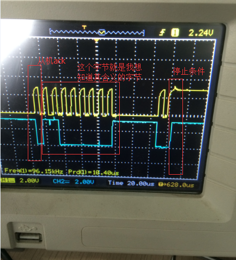

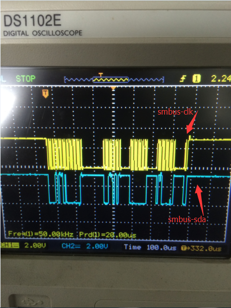

I have use TI EV2400 connect bq40z60 for test , I meet below issue .
1.  I want to know what's the means of the  end of the Byte ?  pls help to explain the spectrum show , I guess that may a  CRC mark ,but I 'm not concern it .
