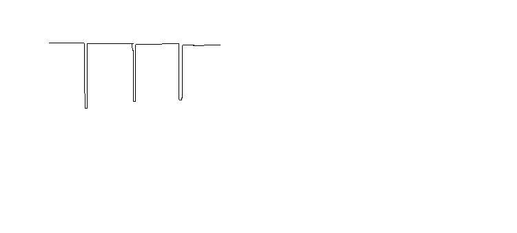

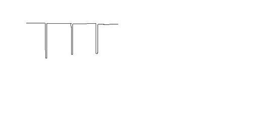

    When mosfet is on the circuit I cannot record the gate to source voltage because as soon as I give the energy, mosfet burns. But when mosfet isn't on the circuit, I read approximately 9-10 volt on the gate to source voltage. I cannot capture the waveform but I try to describe. It is look like square wave but it has sudden ripple in very short time. So the gate is almost ON in one cycle.
    I try to draw the gate to source voltage on paint like as below.
