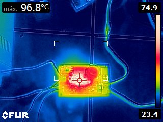

i´ve been working with the lm3429 driver and i have problems with efficiency and heat (heat in the mosfet).
Vin: 12-24 V (12v nominal)
Vout: 46.6V
Iout: 1.2A
How can i get better efficiency? which of mosfet should i use for better heat dissipation(mine is SUD35N10-26P-E3 of vishay)?

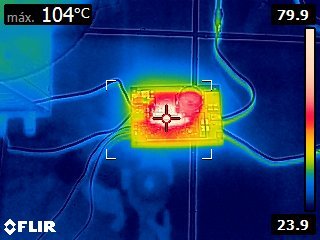

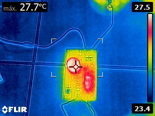

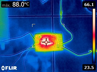

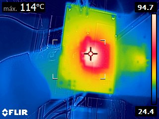

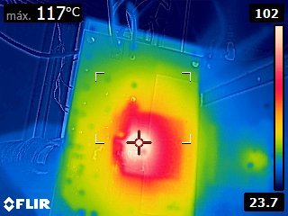

    Below, there is a register with the  MOSFET working temperature, :
    t (s) ---- temperature (°C)
    0     ----  26.2°C
    14   ---- 40.0°C
    26  ---- 57°C
    51 ----67°C
    97 ----77°C
    220 ---- 87.6°C
    399 ---- 97°C
    888----104°C
    369 ---- 104°C **
    545 ---- 110°C**
    758--- 113°C**
    900---117°C**
    Notes:
    1) MOSFET is placed on bottom layer.
    2) The measures with asterisk (**) is the region in direct contact with the MOSFET.
    Also, I send some pictures with the thermal camera.
    Thanks for your support John

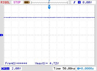

  • That's interesting, so VCC current limiting isn't the only factor. Have you looked at the switch node waveforms to make sure there isn't any oscillation or noise related issues and also to verify the switching frequency? Is the output current regulating correctly without any oscillations? That really isn't a bad FET for this application as long as you have a low enough switching frequency. I wondering if there are any layout issues?

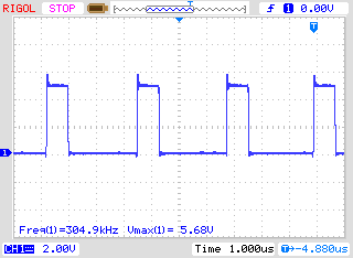

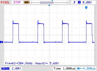

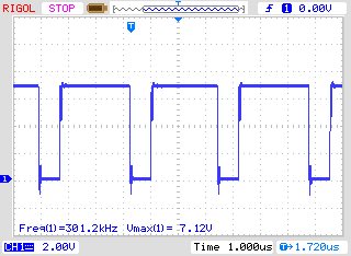

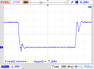

  • Here are the waveforms, i think they are ok but if you see something wrong let me know, thanks for the help.
    Switch node (10x attenuation)
    Output LEDs (10x attenuation)
    Gate signal
    Gate signal zoom
    IS signal ( i change the current limit resistor to 0.025ohms if i did not do it i does not reach the output current of 1.2A )

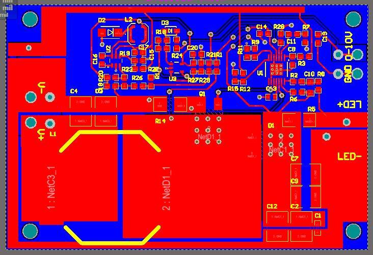

    if you need the layout could you please give me your email.
    Thank you very much for your support.
  • It seems to be switching ok. Is this possibly just a thermal issue such as not enough heatsinking? You are running pretty high input current (this is a high power application) and you are burning over half a watt in the inductor, almost half a watt in the current limit resistor, and over half a watt in the FET. They are all close together and connected in a small area. It's possible that there just isn't enough copper there for heatsinking purposes. Inadequate heatsinking will manifest itself in that way since as the FET gets hotter its Rds(on) increases so it gets even hotter until you have thermal runaway. You may need to use thicker copper, or a bigger package for the FET and the resistor would help, or in the end if the board needs to be that size (you can't add more copper or inner planes to help heatsink) you may need to use a FET with a heatsink.
  • You still might be able to get away with it if you use a better FET with lower Rds(on). Try the NVD5863NLT4G from On Semi or the Fairchild FDD13AN06A0. Both have lower Rds(on) and lower gate charge than the FET you are using. You will cut down the power dissipation significantly and it might be enough.
