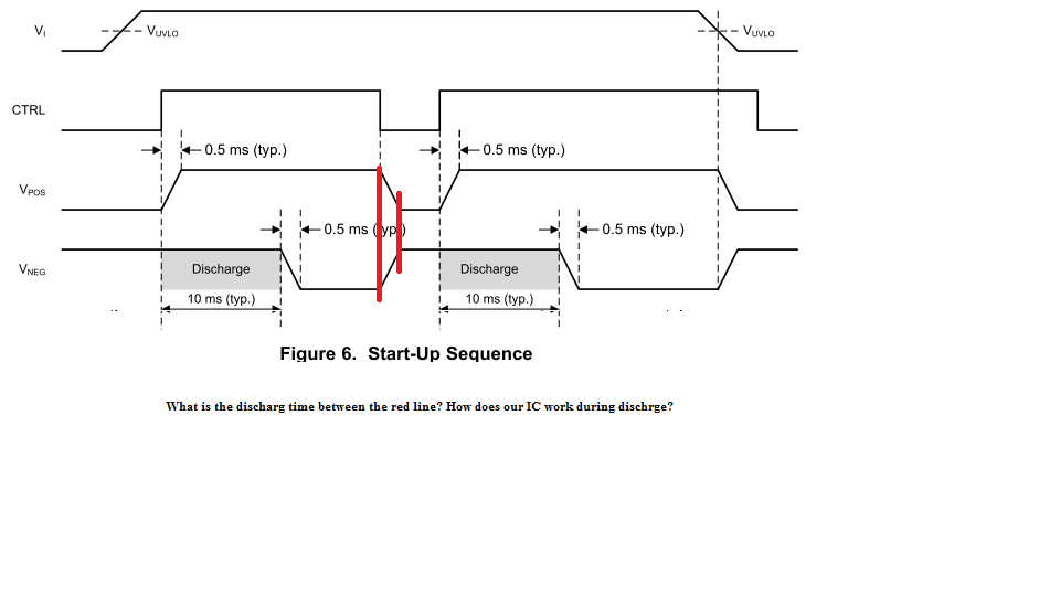

    The input is from battery, which ranges from 3.4V ~4.25V; Vposis 4.6V, Vneg is -2.4V.  The TPS65631W is controlled by driver IC through CTRL pin.
    They didn't tell me the  discharge time requirement and they let me to provide the discharge working method and the time our IC needed to discharge.

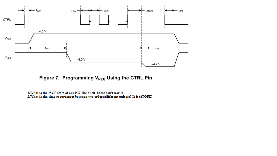

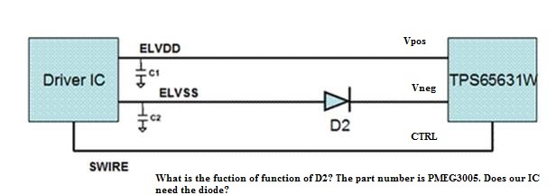

    I also listed several other questions in below pictures. Could you help with this? Thanks. The customer is doing smart watch and their volume is around 500ku.

    When the CTRL pin goes low, the outputs are high impedance. This means that the control of the discharge is not implemented. However it is possible to implement that function with external components.

    1) When an error condition is detected, the device goes into shutdown and the input and outputs are disconnected. The different error conditions are listed in section 8.3.6 (Short Circuit Protection) of the datasheet.
    2) At least the maximum value of tsore is needed before you send another pulse package.

    With D2, current can flow only when Vneg is negative enough. Our IC do not need the diode. Where is this picture from?

    I checked your schematic and it seems ok to me, but the diode D1 is not necessary for our IC.

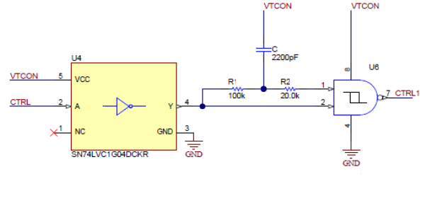

    About adding switch method, the ctrl is used to control the switch. Another problem is that except discharge, driver IC will also send pulses to adjust the negative voltage which will affect the switch state,too. How to solve that? Thank you.
    Best Regards
    Janet
  • Hello Janet,
    To solve this, I propose to use the circuit below. The values of the RC filter components were selected such that all frequencies higher than 1 kHz are filtered. Therefore the pulses whose durations are between 2 us and 25 us will be filtered.
    This will allow you to generate a new signal CTRL1 to control your switch.

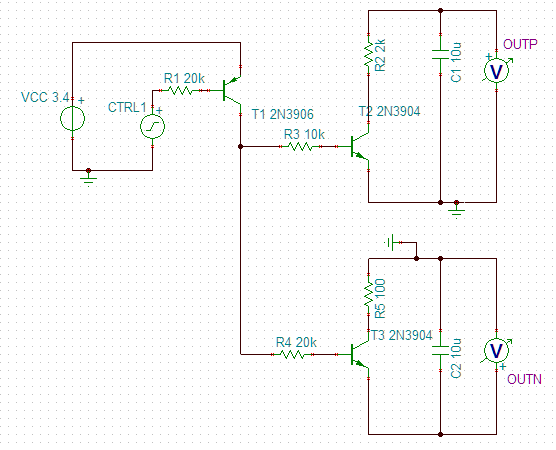

    For the first problem, I think we can use a and logic instead of 1G04, for the negative voltage, can we use a Mosfet? It looks like the load switch can't endure negative voltage. If we choose the mosfet, which part do you recommend?
    Looking forward for your reply. This project is urgent for us to win. We need to accelerate the progress. Thanks.

  • Hello Janet,
    I propose to use the circuit below for the discharge:
    I also noticed that you are using the NAND gate SN74AHC1G00, I would recommend to use the SN74LVC1G132 instead in order to avoid having jitters on your signal CTRL1.

    Thank you so much for your continuous support. Just one more question, do we adjust the resistor R5 to adjust the discharge time ?
    Thanks you so much.
    Best Regards
    Janet
  • Hello Janet,
    Yes, you adjust the resistor R5 to meet the discharge time requirement on OUTN and R2 for OUTP. It will take approximately 3RC for complete discharge.
