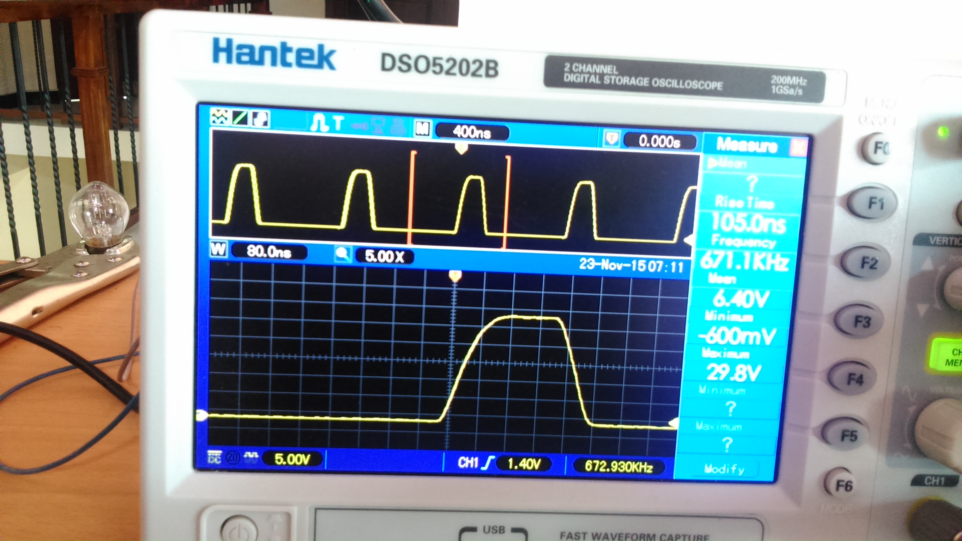

    HG pin output

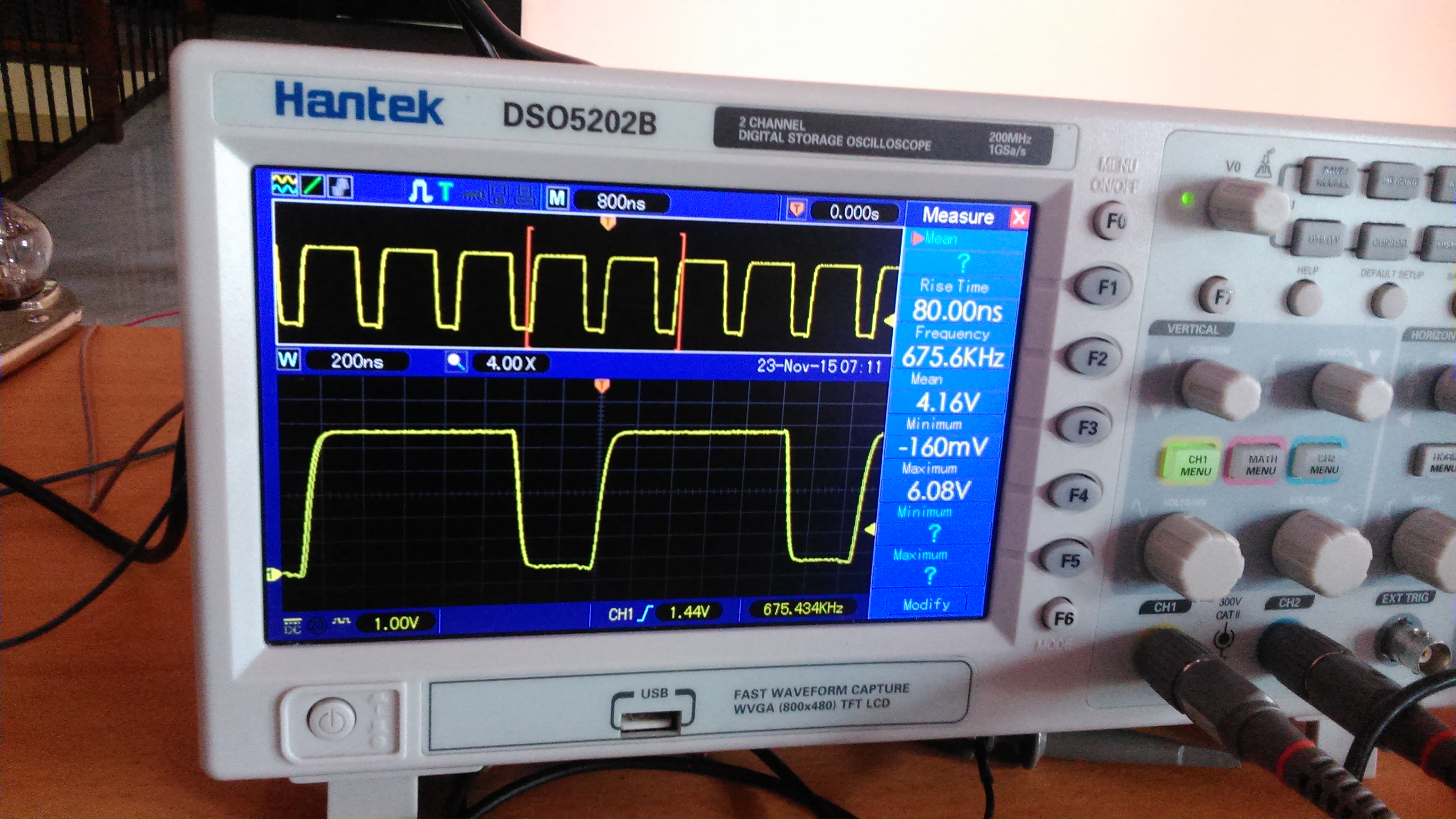

    LG pin output
    The switching frequency is around 675Khz
