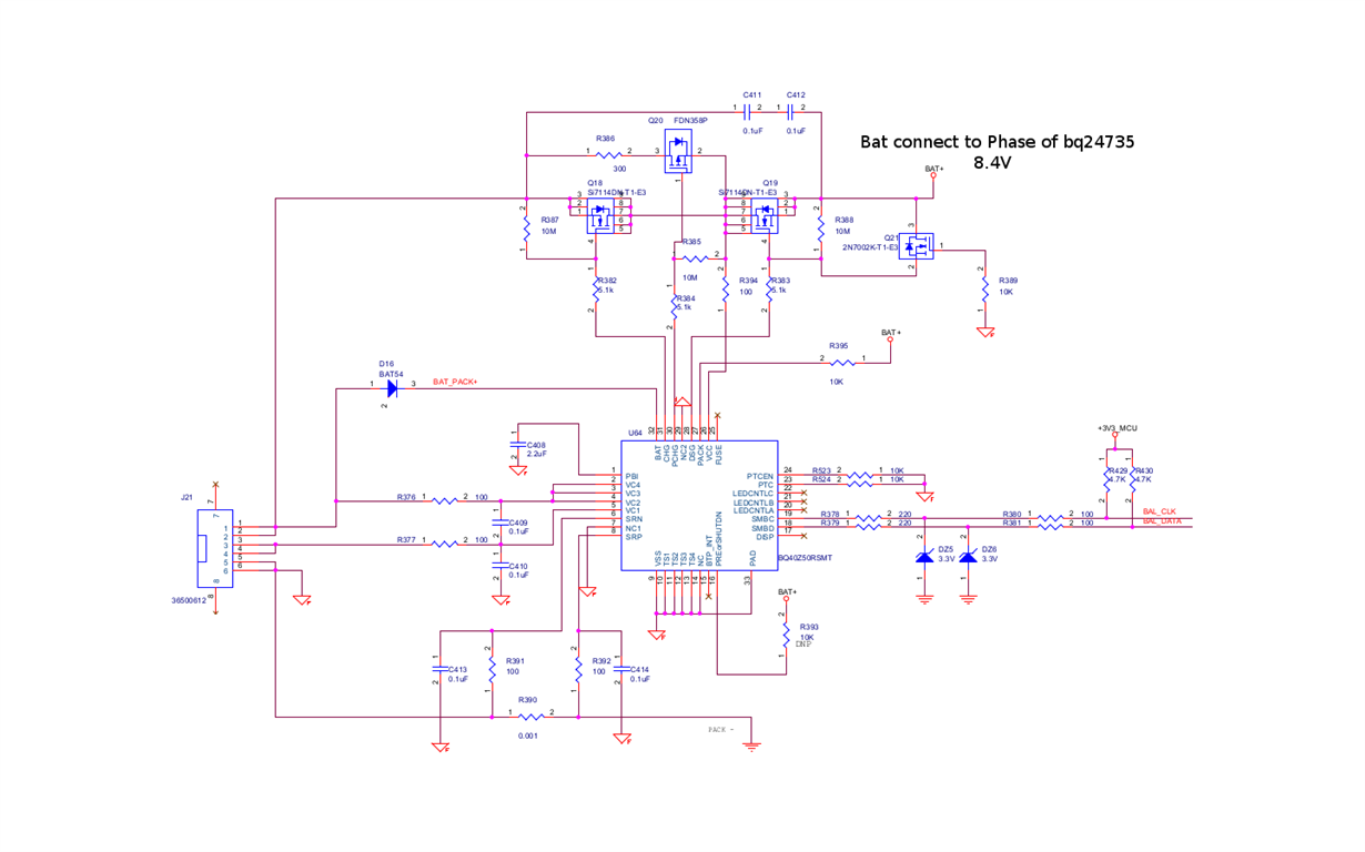

  • Hi Justin,
    I send you my schematic of bq40z50. BAT+ is connected to Phase of bq24735 (I config it 8.4V output).
    Some feature be changed in the schematic:
    + PRESS connect to gnd.
    + Fuse  connect to gnd
    + MOSFET Q21 pin 2 to BAT+, pin 3 to R388
    Thank you very much,
    Phien Nguyen
  • Hi Phien,
    Do you still see Safety status: 0x08000000 (Undertemperature During Discharge: detected)
    Your SS bit may be set because of one of the safety statuses being set, thus not letting you charge/discharge
    Can you use an EV2400 to create a log and send us an SREC? If not, can you send me the Temperature Enable and Temperature Mode contents
