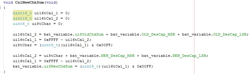

I fail to update the design capacity to 1800 (0x0708), can you ensure my step is correct? I done a read after i write new capacity and it report 0x07 0x08, which means my capacity changed successfully, but I guess I am facing some issue on calculating the checksum, can anyone help to advise me on the calculation?

13. (WR 0x60 new checksum) write new checksum (new checksum = 0x40, formula provided by datasheet)
**fail to write new checksum to bq27510, process stop
