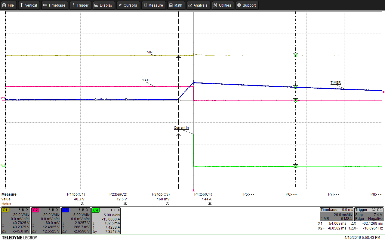

    NOTE: All waveforms are taken with respect to Vee as the oscilloscope probe ground.
    First waveform is using a constant current electronic load, gradually raising the current. When performing this test, you will see the TIMER pin begin to charge, while the GATE does not move. This is because the TIMER pin will begin to charge, just below the current limit regulation point. This is made to ensure the TIMER is always running whenever the circuit is in regulation.
    So the TIMER begins to run around 7.4A, which is much less than the 8.67A current limit set point of the EVM (based on 3mohm sense resistor). I will need to investigate this further, probably by checking the Vsns voltage across the sense resistor.

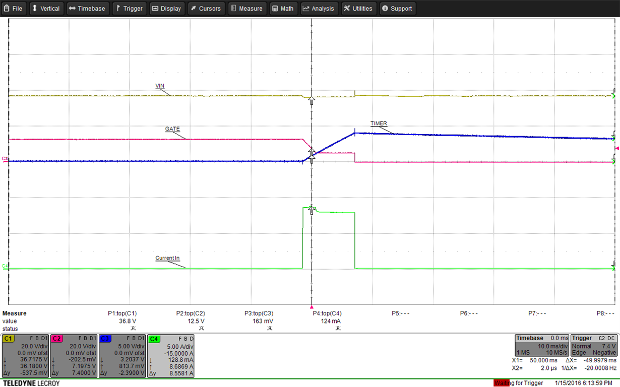

    The next test was a load step using a constant current electronic load.
    Here the gate voltage is reduced and the circuit is in regulation. Here the current is a little higher, at 7.82A.
    For the last test, I used a resistive load and hot-plugged.
    Here we can see that the device began limiting the current to 8.69A (which is right at the current limit set point!) but this was for a brief duration of time. Quickly, the circuit reduced the current and continued to regulate.

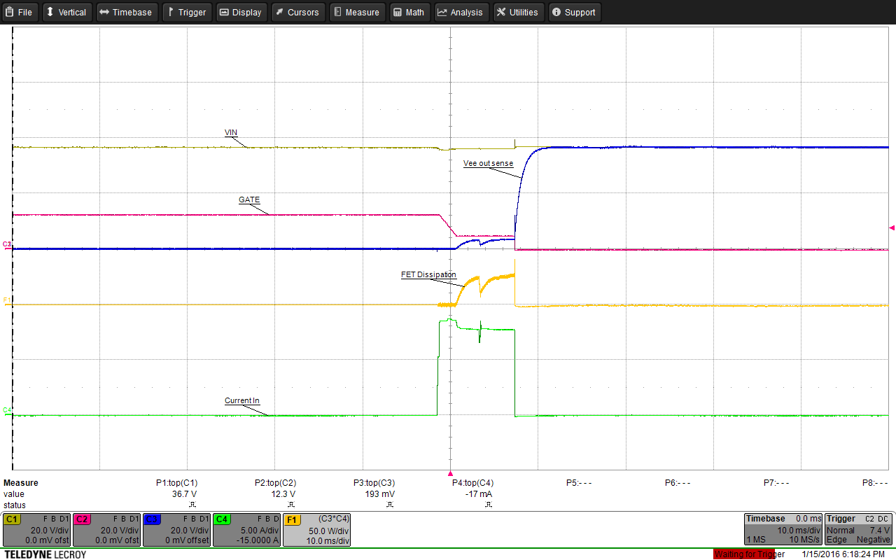

    I performed the same test but captured Vee_out_sense in order to check what the MOSFET power dissipation looked like.
    Here we can see the MOSFET power dissipation is around 25W, which is well below the power limit. So it may not be in power limit regulation, but yet the current limit was reduced. Will need to analyze further.
    So overall we are able to replicate some inaccuracy in the theoretical set point threshold and the measurement on the bench. We will need to check what is the root cause.
