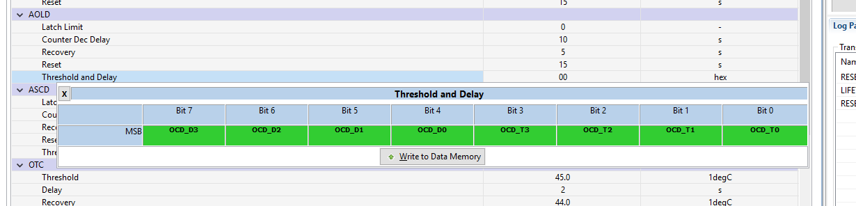

  • Hi Tom,
    Thanks for the quick response. The AOLD and ASCD work. It was an error on my part. In BQ Studio, I didn't press the Write Data Memory and re-check if the value was properly written in the flash.
    But I also wanted to point out a problem with BQ Studio. The BQ78350 R1 TRM and BQ76940 datasheet show only bits 6-4 for OCD_D0-D2. BQ Studio shows bits 7-4. I've attached a snapshot to show what I am talking about.
  • Thanks for the info. That looks like a tools problem and I will have it fixed.
