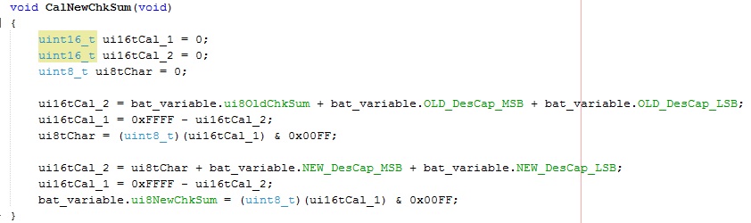

I fail to update the design capacity to 1800 (0x0708), can you ensure my step is correct? I done a read after i write new capacity and it report 0x07 0x08, which means my capacity changed successfully, but I guess I am facing some issue on calculating the checksum, can anyone help to advise me on the calculation?
 Here is the steps I use to make the changes:
1. (WR 0x00 0x14 0x04)  - unseal
2. (WR 0x00 0x72 0x36)  - unseal
3. (WR 0x00 0xFF 0xFF)  - full access
4. (WR 0x00 0xFF 0xFF)  - full access
5. (WR 0x61 0x00) - enable block data flash control
6. (WR 0x3E 0x30) - design cap sub-class id is 48(0x30)
7. (WR 0x3F 0x00) - design cap (0ffset = 10)
8. (RD 0x60) read old checksum (old checksum = 0x64)
9. (RD 0x4A) read old design cap (MSB = 0x03)
10. (RD 0x4B) read old design cap (LSB = 0xE8)
11. (WR 0x4A 0x07) write new design cap (MSB = 0x07)
12. (WR 0x4B 0x08) write new design cap (LSB = 0x08)
13. (WR 0x60 new checksum) write new checksum (new checksum = 0x40, formula provided by datasheet)
**fail to write new checksum to bq27510, process stop
14. (WR 0x00 0x41 0x00) reset gauge
15. (WR 0x00 0x20 0x00) seal

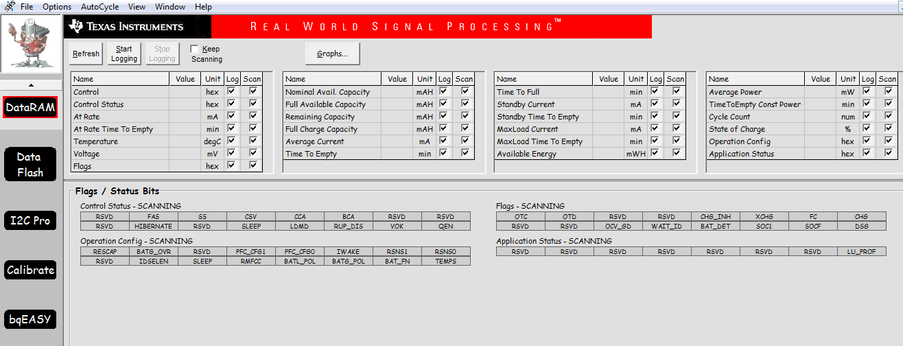

  • Hi Jason,
    The design capacity is not supposed to return to the default value given that this is a flash based gauge and not a ROM gauge. You are likely doing something incorrect. The best approach for evaluation will be to use bqstudio and i2c communication to configure all the necessary settings, carry out your learning cycle and once that is done, extract a bqfs or dffs or srec file which will be used to flash multiple devices. You do not need to run the learning cycle on multiple chips, just only on one while the rest will be flashed with your golden image extracted from that chip that you ran the learning cycle on. bqstudio allows to extract all these types of files depending on which one you want to use.
    let me know if any aspect of the process needs clarification.
    thanks
    Onyx

  • Hi jason,
    You certainly can flash the chip using your host controller. What you need to do is , configure the gg.csv file for your application (a gg.csv file can be extracted from a bq27510evm and bqstudio), program the gg.csv file on the evm, program your chem id on the evm,  perform the learning cycle using your battery and the EVM and then extract a dffs. You will now flash multiple devices using your host and this dffs file.
    Attached is app note that describes what to do when programming using your host and a flashstream file (dffs).
    slua541.pdf
    Flash Stream File Format.pdf
    thanks
    Onyx

  • Hi Jason,
    Sorry for the delayed response to this, I have been out of office for the holidays. see attached app note on how to carry out the learning cycle process.  bqstudio does not have a plug in that guide you through the process, so you have to do it following the process in the attached files. it is a fairly straightforward process.
    learning cycle.zip
