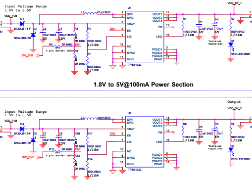

  •  Kindly find my circuit and is it correct?
  • Hello Second circuit is for 5V@250mA output
  • 1. the 47uH is too large. during the startup of this device, the input current is 0.4*Isw=1.6A, I guess it is not easy to find such a inductor. and large inductor may cause stability problem. you can use 10uH inductor for both application.
    2. the output capacitor is too small. please used a 47uF tan cap.
    another device that can support 5V&100mA is the TPS61070, this device is simpler than TPS61032.
