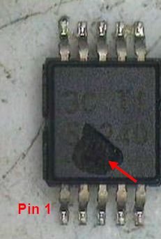

My customer facing repeated problem for TPS54240 burnt issue.
Most probably the IC is damaged by EOS and they are studying their application circuit and design to improve.
Most of the defect samples have mold compound crack near pin 2 and pin3 as picture shown.
Please suggest possible causes and method to improve.
Customer application : Vin max=39.5V, Vo=16V, Io=0.5A, fosc = 536kHz.
Thanks.
Chin

    5) Based on the failure samples(from last year till now), most of the defect samples has the mold compound cracked near pin 2 and 3.

    Few defect samples had been analysed by TI
    #1: Open pin: pin 2  ; Short pins: pin 1, 3, 4, 8, 9, 10
    #2: short pins: pin 3, 9
    #3 : Open pin: pin 2
    #4 : Open pin: pin 2 ; Short pins: pin 1, 7, 8, 9, 10
    Seems like pin 2 opens and pin 3 & pin 10 shorted to GND are having high occurrence. Any hints or inference that you able to get from the analysis?
    Thanks.
    Chin
  • Usually when there are multiple pins shorted, that means metalization flash has occurred. Typical scenario is over voltage causes high side FET to short. Now high current occurs and metal layers may melt, shorting other pins.
    Pin 2 open means bond wires have most likely fused.
    Pin 3 short may indicate some issue with EN, but could be random shorting from above.
    For the ceramic input capacitor, you should place it closer to the IC than the AL electrolytic.
    Back current would have to come from Vout being pulled above Vin so the body diode conducts.
    It may possibly be ESD damage, I suppose you could test a board for susceptibility.
    That clock change does not vary the frequency much, but who knows what happens during transient switching between them. RT pin is extremely sensitive. It is possible that switching frequencies is causing stress, especially if the Fsw dips very low during transition.
    It is always difficult to capture these type failures. They are almost always caused by external conditions or layout, not faults with the IC.
