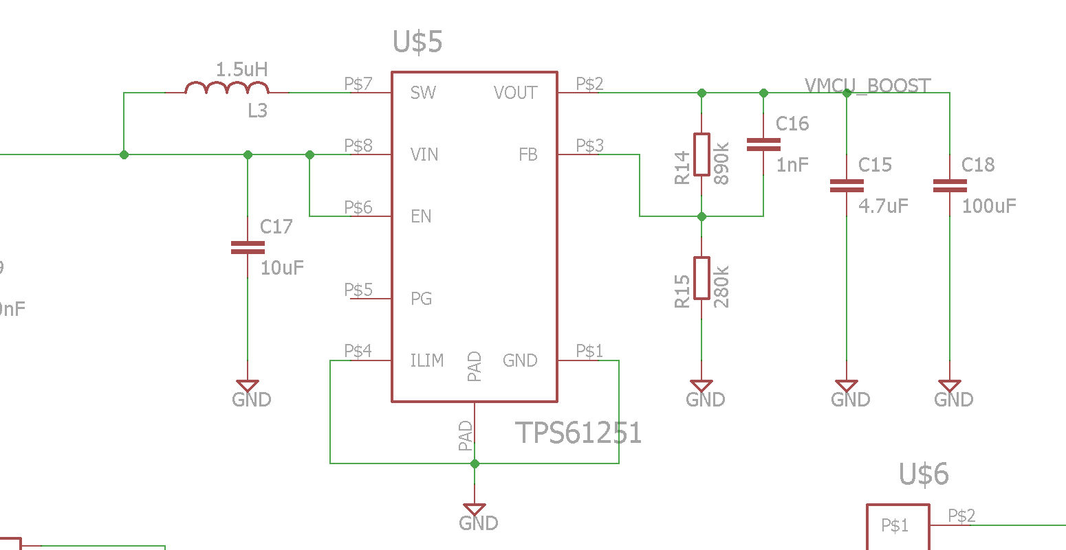

TPS61251 not limiting current
Other Parts Discussed in Thread: TPS61251
Hello, please see the attached schematics of my circuit using a TPS61251. The input voltage is 2.7-3.2V, and the output set to 5V. The load connected to the output will exceed the current limit most of the time (it will draw 300mA if the power supply is able to source it). ILIM is connected to ground to set the current limit to 100mA. However, I still measure the input current to be constantly at 300mA?
