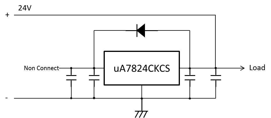

Hello Team,
Customer will use uA7824CKCS in the following circuit configuration if input voltage is 24V.
(The input terminal of device is supplied if input voltage is more than 24V.)
Is there any problem in this configuration?

  • Matsunami-san,
    Im not quit sure what you are trying to achieve. I am not familiar with this application. Could you please explain further?
    Is the 24V input increasing or changing?
    It looks like the uA7824 wont be doing anything until the 24V increases to have the appropriate input voltage on the LDO at which point the dropout will be fighting the rising 24V.
