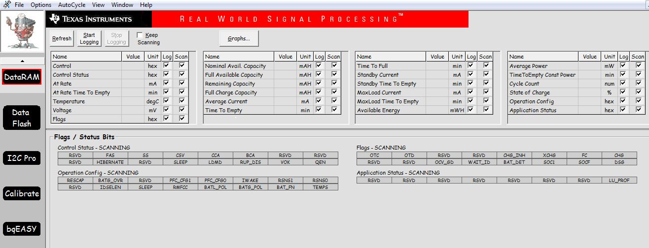

    So, to extract the golden file, do i need the TI's BQ Evaluation software or any 3rd party software?
    In order to run the learning cycle, it needed I2C communication and TI's BQ Evaluation software.
    Currently our side is using the UART communication and 3rd party software platform to program the BQ27510-G3 instead of the BQ Evaluation software.
    BR,
    Jason
  • Hi Jason,
    Yes, you would use bqStudio with the device connected via the I2C communication of an EV2400 or EV2300 to create the golden file. Afterward you can use this golden file to flash your production devices.
    When the learning cycle is successful, you will go to the Golden Image tab of bqStudio, and here you can generate the files used for production.
    Justin

  • Hi Jason,
    It's okay if you only have I2C communication to the gauge via your host, you will still be able to write to the gauge. After completing you learning cycle, you can generate a DFFS file (in the golden image tab of bqStudio) . This will have all the parameters that make up the data flash. Your host will parse the data and use this to send blocks to the gauge.
    In section 1.1 of this app note, you will see the meaning of each of the letters (W,R,C,X). You can use this DFFS file to program your gauge.

  • Hi Justin,
    For the BQstudio, can you please send the the instruction on how to perform the learning cycle?
    I cant find any interface at the bqstudio that is used to perform the learning cycle.
    BR,
    Jason
  • Hi Wang,
    bqStudio does not use a built in tool to perform the learning cycle. You can run a learning cycle by following the guidelines in the app note I posted in the first post of this thread.
    If you have a GDK, you can use the GDK tab in bqStudio to set up an automated charge and discharge schedule that matches the guidelines in the appnote.
    If you are not using a GDK, you can use a source meter instead for the charge and discharge.
    Justin
