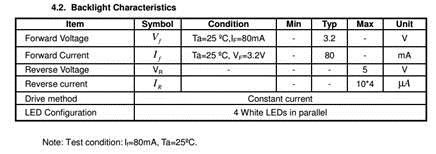

I want to use TPS7510 for 4P LED application.
Due to LED connector only have 2pin, 1 anode and another cathode, so we might tight D1A/ D1B/ D2A/ D2B together.
Is there any side effect for this connection?
Regarding to the PWM Dimming spec, I saw the limit is min on-time is 33uS, so max Dimming frequency is 30.3KHz right?
