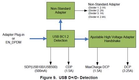

Can TI recommend some of the shelf manufacturers of dedicated charge port adapters that will support the higher output voltages and work with the bq25895. Looking for a wide range of suppliers to test the capabilities of the bq25895.
The bq25895 contains a D+/D– based input source detection to set the input current limit automatically.
The D+/D- detection includes standard USB BC1.2, non-standard adapter, and adjustable high voltage adapter detections.
