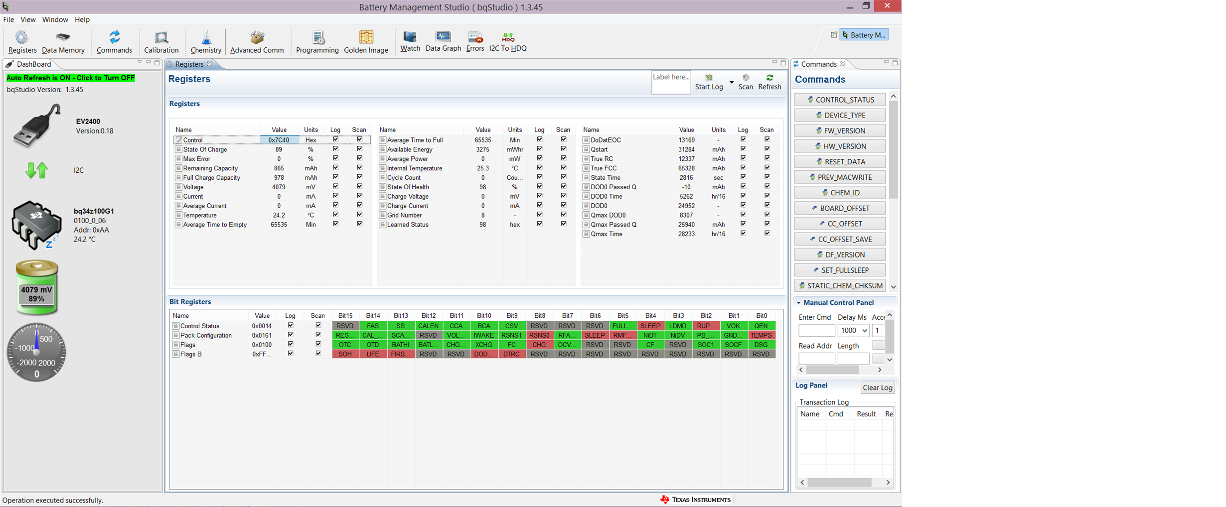

  • Hi Thomas,
    Section 8.3.15.6.1 of the datasheet covers the instruction for converting from I2C mode to HDQ mode. The procedure looks very straight forward but I am still having trouble writing data [0x7C40] to Control value field.
    Here is what I did:
    1. I navigated to Register Screen and double click on the control value field.
    2. I then typed 0x7C40 and enter (I can't not find the "OK" button as described in the datasheet).
    According to the datasheet instruction, the conversion suppose to complete in about 200ms. However, it seems that the data was never written into the register. I clicked the refresh button in the Register screen and the control register value is back to 0x0014.
    Maybe you can help me to locate the "OK" button?
    Jeff

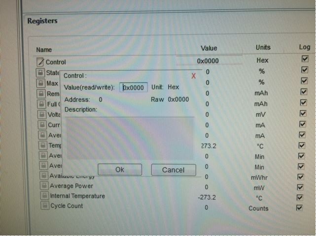

  • You should see a pop-up window, if you click the data field one time.
  • For some reasons, I do not see a pop up window when I click the data field one time.

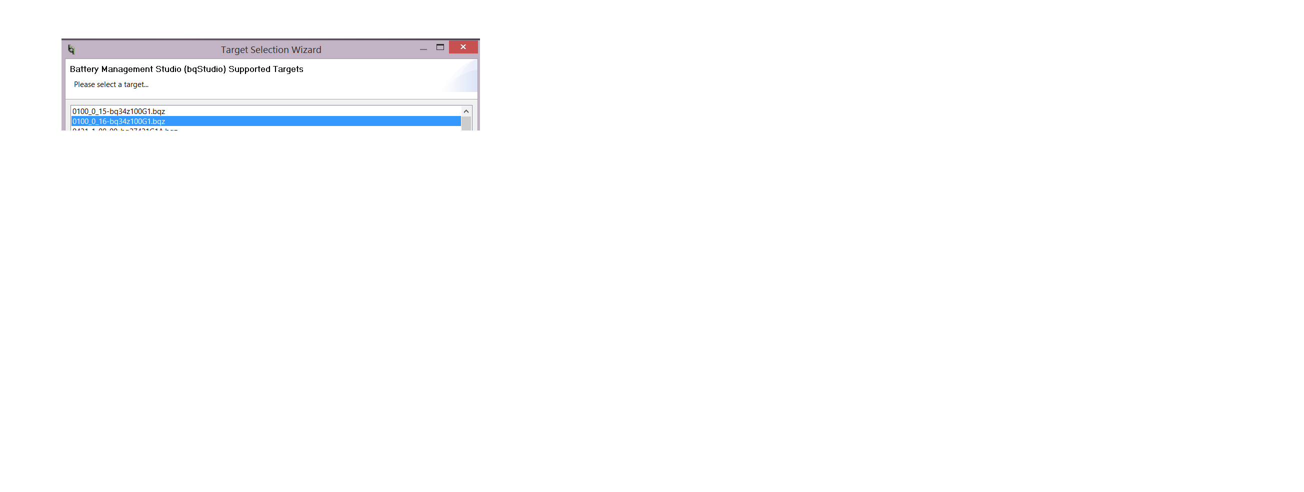

    I am currently using bqStudio 1.3.45 and I chose the following for the battery gauge (auto detected device: 0100_0_06). Please let me know if you see any problem. Thanks!

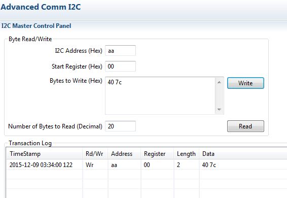

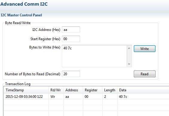

  • That is one problem. You have the old bq34z100 firmware loaded and bqStudio does not support it. You need to update the firmware to the bq34z100-G1 and the firmware can be downloaded from the bq34z100-G1 website. If you want to continue using the bq34z100 firmware, then you will need to use the bqEVSW platform instead of bqStudio. Also, the older device does not have a temporary switch to HDQ mode option.
    One the popup window issue, you can also use the Advanced Comm screen to enter the data.
