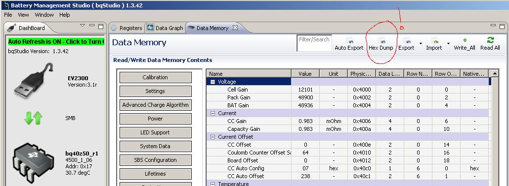

I want make goldan image of bq40z50r1 product.
But, I can't fined Hex Dump button(written in slua743.pdf) on bqStudio.
Please tell me how to hex dump, or how to know the ending row address of the data memory.
See attach screenshot.
After press this button will be create file:
* Texas Instruments Data Flash Binary Image File.
* All values are hexadecimal and begin at Data Flash Offset zero.
* File created on Wed May 04 20:03:07 2016
* Device Name bq40z50
* Device Identifier bq40z50 v1.06 build 36
* Off-
* set +0 +1 +2 +3 +4 +5 +6 +7
0000: 45 2F 04 BF 28 BF 52 D7
0008: 71 40 A9 94 89 49 00 00
0978: 46 00 00 50 FF FF FF FF
