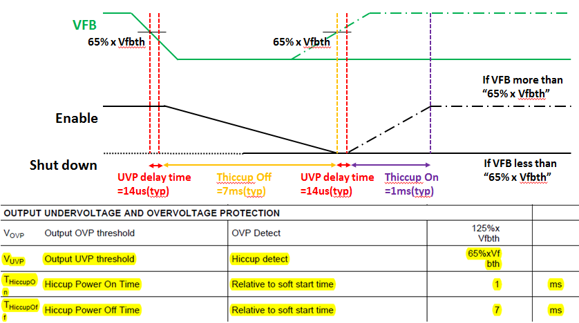

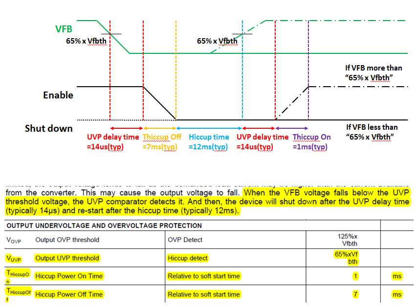

If this device have the output voltage discharge, does this become active when UVP work?
[Q3]
I show operation of UVP in the figure.
Please tell me if I make a mistake.
