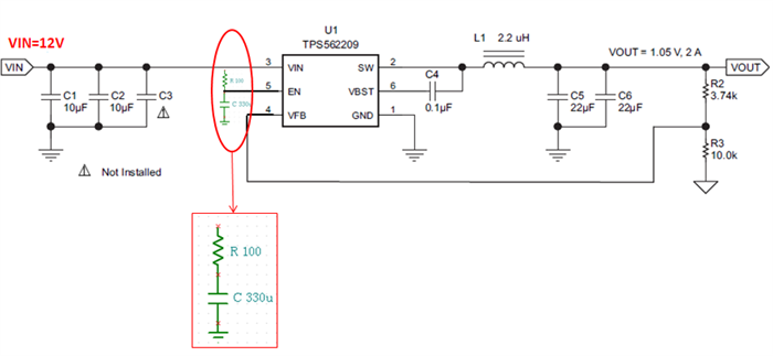

Hi Team,
Our customer would like to control the startup timing.
1. Vin reaches 12V in 8ms.
2. Then, Vout stands up
They can't use MCU so they have to connect EN to VIN.
Therefore, they are studying RC delay circuit of EN.
Is there the limit level of the capacitor and resistance?
Currently, we are going to use "100ohm & 330uF".
Kanemaru

    Therefore, our customer would like to use TPS562209 with RC circuit of EN.

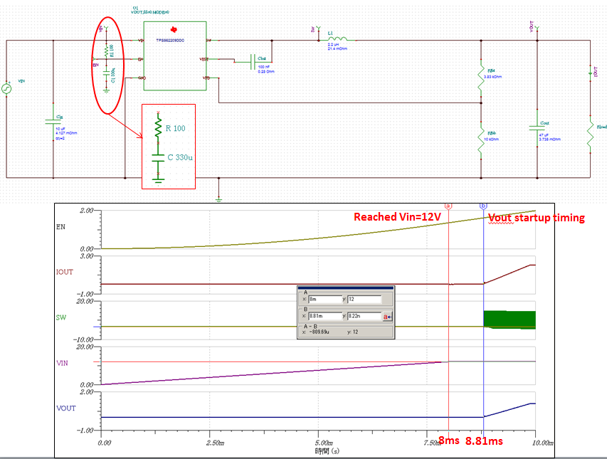

    I tried simulation.
    I understand that this circuit does not have the problem.
    Could you please let us know if you have any concern?
    Kanemaru
  • I cannot think of any reason why there would be an issue adding the capacitor. But you are the first I think to try it.
