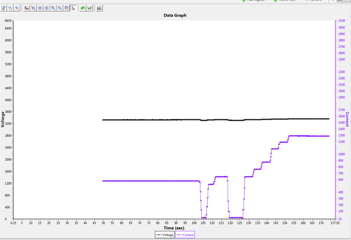

I am graphing the voltage and current of a bq40z50.  After several hundred points being graphed in the "Data Graph" tab, the points on the left hand side start disappearing as new points are added on the right hand side.
I would like to graph an entire charge cycle.  Is the Data Graph tab limited in the number of points it can display?
  • Hi David,
    I see you are trying to view the voltage and current over an entire cycle. Have you tried to go to the Registers tab and use Start Log? This will allow you to track these parameters and save them to a log file. You can then copy the log file into a spreadsheet.
