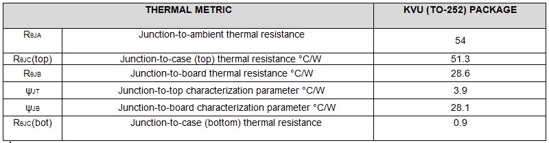

Dear, All
It is a question about the thermal resistance of LM317M.
In DCY PKG of this IC, thermal resistance is written to the datasheet, but KTP PKG and KUV PKG is not written it.
Please tell me θja of KUV PKG.
Thanks, Masami M.
