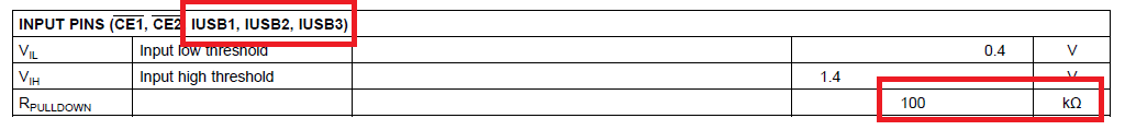

Dear Sir,
I think there is a mistake in the BQ24266 PDF:
It is mentioned that IUSB1,2,3 Pins have a internal pull down resistor of 100kohm (see attached pic)
I have tried measuring the input resistance of these pin and there is no 100kohm resistor in any of them...
However, CE pins do have (measured resistance is 95.7kohm)
Please check,
Thank you
