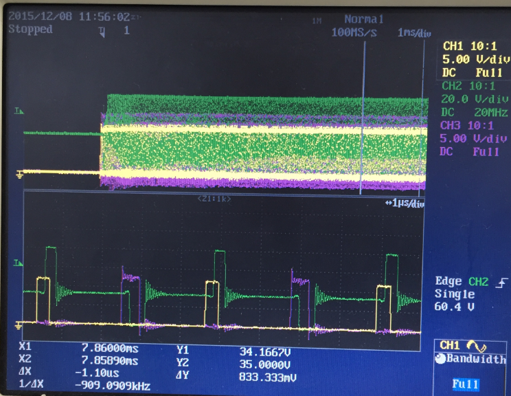

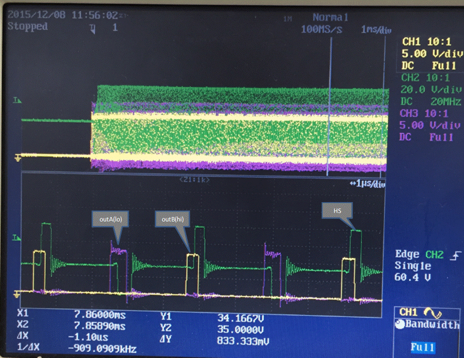

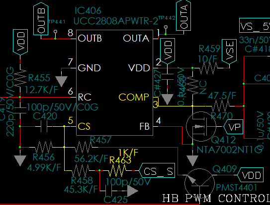

My customer used UCC2808A to deign half bridge to apology and found the duty un-matching issue at soft start condition.
OUTA is always larger than OUTB around 100nS.  That would cause transformer saturation.
Can you help to check and give some suggestion for this issue?

schematic:(Cs=0, fixed signal by compensation circuit  with  from Q409 )

start up waveform:
