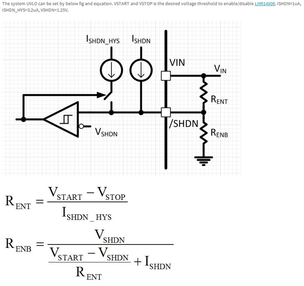

I'm using a LMR16006 simple switcher and I'm using the !Shutdown input to get an undervoltage lockout.
Im using a voltage divider with 330k and 22k. This results in a Vstart = 19.7V and Vstop = 18.7V. Vhysteresis is about 1V.

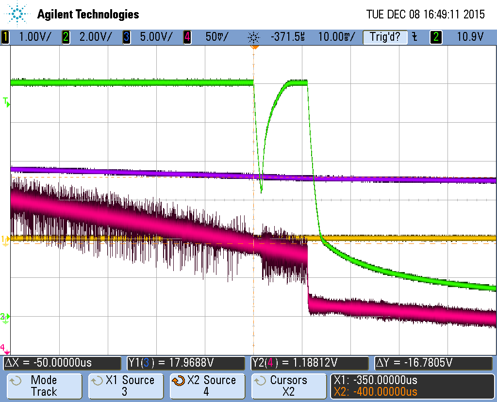

When I tested the circuit I found that the switcher doesn't stay shutdown. It comes back up only to shutdown again after a couple of milliseconds.
See attached scope (Ch1 = open; Ch2 = LMR16006 output voltage; Ch3 = Input voltage; Ch4 = voltage at !shutdown pin of simple switcher)
First I thought that this is probably due to the noise on the shutdown pin. But at t = 0 (where it seems that the shutdown is triggered) the voltage at the shutdown pin should drop by about 66mV (3µA * 22k || 330k) but it doesn't. Which makes me think that the shutdown logic may not be responsible for the first dip in the output voltage. But what is?
