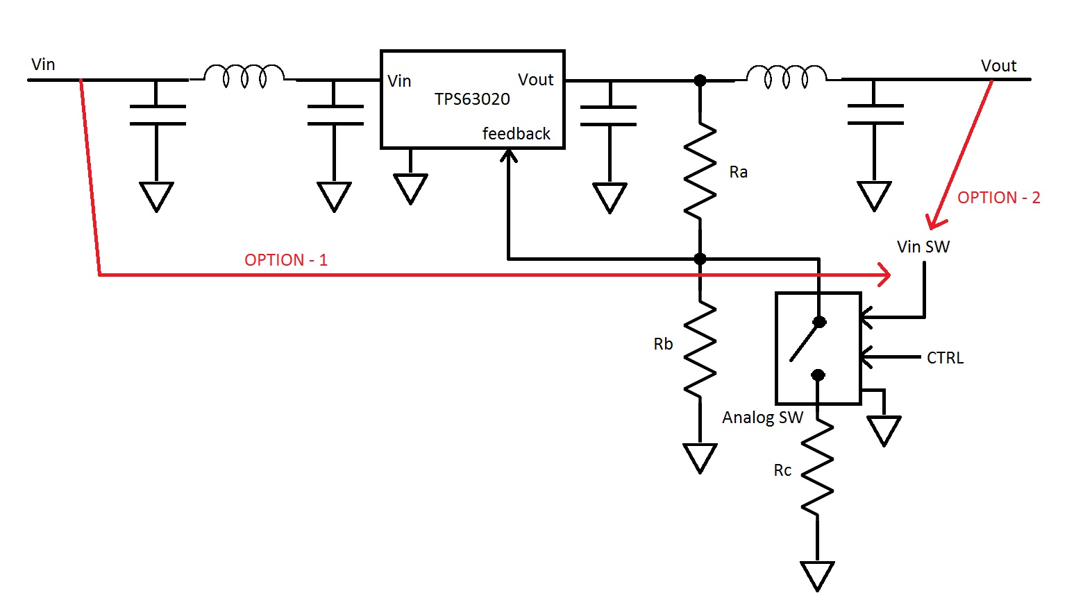

Hello all,
In my project, I'm using the TPS63020 as my main power converter.
I need to switch between two different output voltages (3.5V & 5.0V) using a single logic input - only at light loads (~100mA)
One idea is to use an analog switch to add another feedback resistor in parallel to the feedback network and by doing so, change Vout dynamically.
question 1 - does anyone have a better/simpler idea than this solution?
question 2- assuming my suggested solution is good enough, what would be the best way connecting Vsupply for the analog switch, Input or output DC-DC voltage?
Thank you all.
