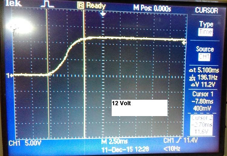

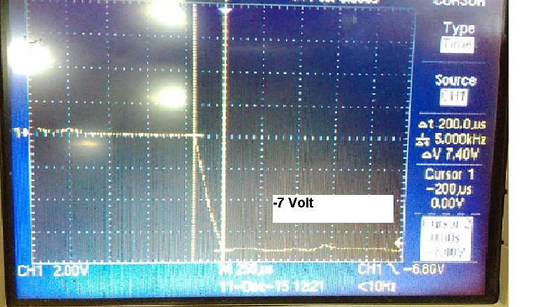

  • Hi Ilona,
    Extremely sorry for late reply..
    I have captured the rise time for 3 voltage levels  VS,VGH,VGL in actual power sequence. Not able capture the waveform in problematic condition.
    I feel there is a relation between fault mode and this issue, I am not able not reproduce the issue if I short the fault delay capacitor(Disabling fault mode) and issue is reproducible if I put back capacitor. I have conformed that All loads are with in range of VS,VGH,VGL current limits.
    Please give your suggestions ..
    Inserting the waveforms captured (In normal condition)
