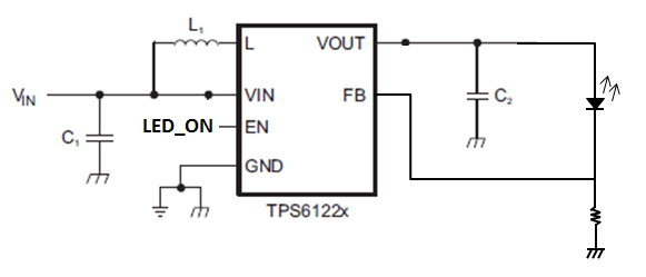

Hi Team,
My customer is looking for 1ch WLED driver for portable application.
The requirement is the following.
- input voltage: 3.4~4.5V
- LED current: 15mA (MAX)
- function: ON/OFF only
Can I suggest TPS61220 with the following schematic?
Is there any concern about the schematic?
