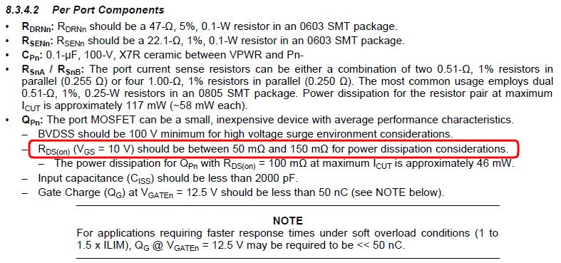

  • Hi CW,
    In our datasheet Section 8.3.4.2, we list some important parameters to be considered for the MOSFET. As long as the FET meets the requirements, it should be fine. I think you can find a good one from TI's FETs.

  • Hi Penny~
    I have one more question for MOSFET.
    Accroding to TPS23861 datasheet section 8.3.4.2, "RDS(on) (VGS = 10 V) should be between 50 mΩ and 150 mΩ for power dissipation considerations".
    But all of TI N-ch NexFET, which are satisfied with BVDSS = 100V, have low RDS(on) as under 20mOhms.
    In this case, we will be unable to use NexFET.  Am I correct??
    Thanks... C.W. :)
  • Hi C.W,
    The Rds_on is for power dissipation considerations. Usually the smaller Rds_on, the lower conduction loss. There should be no problem to TI FETs with 20mΩ Rd_on as long as they meet other PSE FET requirements listed in the datasheet.
