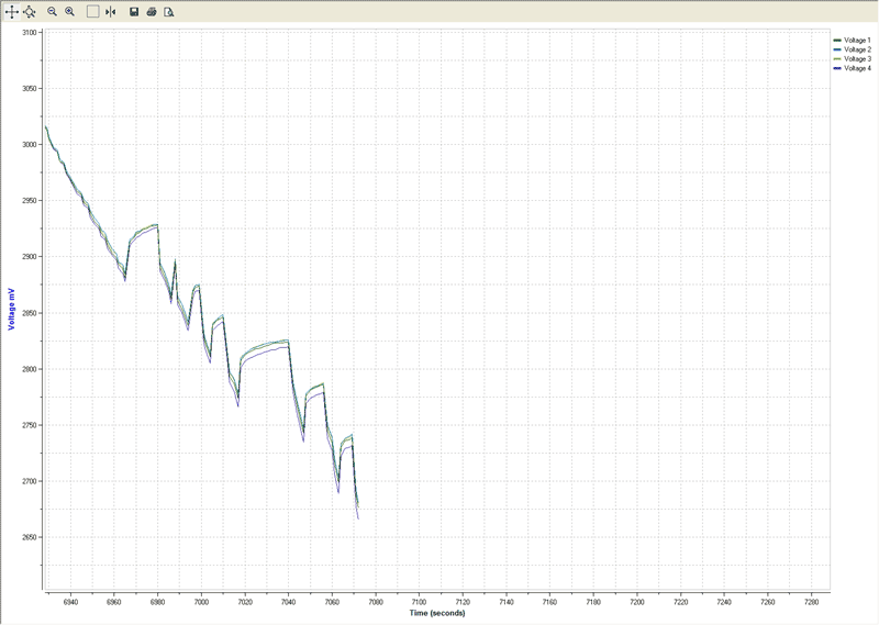

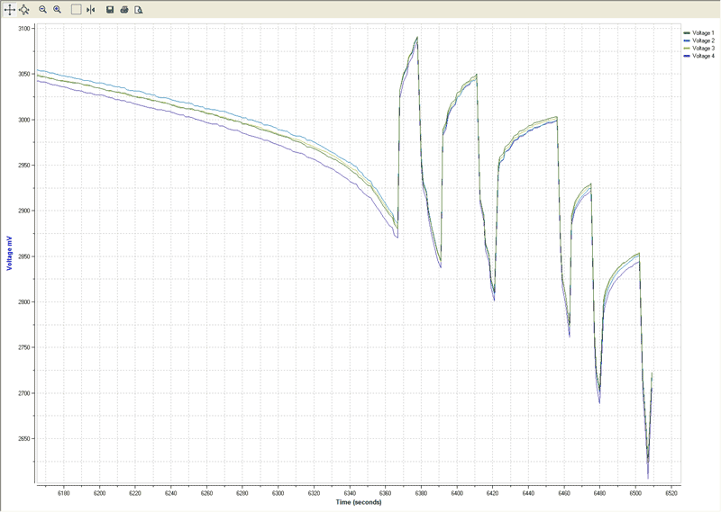

I've attached two screen captures. The first shows the 7.5C discharge and how the DFET keeps turning back on. The second shows a 2C discharge done right after the 7.5C discharge reached the DC voltage. Both discharge current levels show the DFET turning back on after different voltage and timer intervals.
Since the rebound voltage level, and rate of increase, is much higher after a 7.5C discharge reaches the DC voltage level, could this somehow be the cause? This is the only difference I can think of between the 2C discharge (all the way from 100% SOC to the DC voltage) and the 2C discharge I did immediately after the 7.5C discharge reached the DC voltage.

    I set the recovery voltage thresholds to very high levels and tried another 7.5C discharge:
    CUV Threshold = 2600, CUV Recovery = 3500
    PUV Threshold = 10800, PUV Recovery = 14000
    EUV Threshold = 2700,  EUV Recovery = 3500

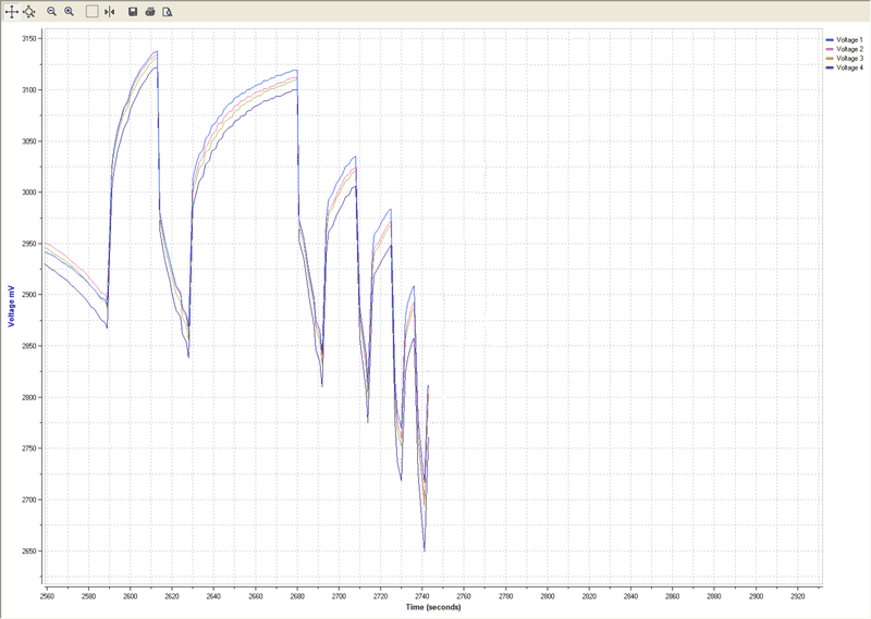

    Below is plot of the end of the 7.5C discharge. The turning back on of the DFET still occurs but, as before, at different voltage levels and seemingly different times (after reaching the DC voltage). I'm sure it's something obvious, but I'm stumped.
  • Is there any clue in safety history ??
  • Good idea, but unfortunately there's no indication of anything going on there.
    It appears to be an interaction between the certain firmware settings, our discharge current level, and the Discharge Complete voltage. We're trying out a bunch of variations of them to try to narrow it down.
