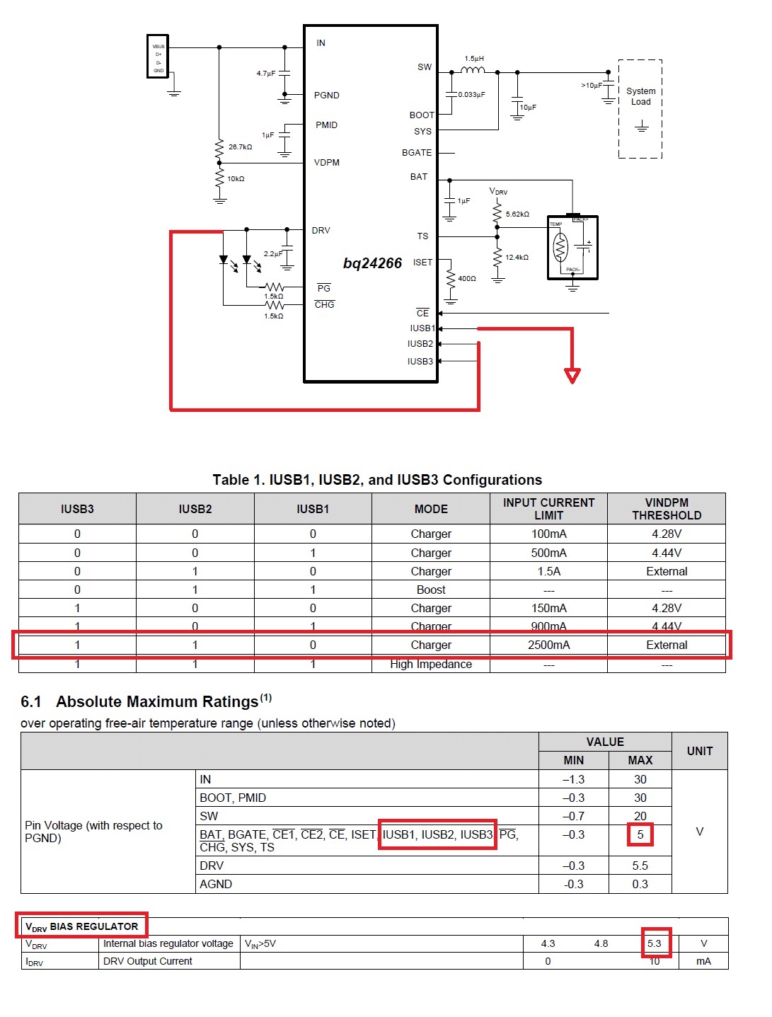

In my application, I'm using BQ24266 while Vin is 5+0.25Vmax (using USB power adapter)
I've noticed that DRV pin can reach 5.3Vmax, while the maximum allowed voltage in IUSB1,2,3 pins is 5V.
I assume that it would never reach 5.3V while Vin=5.25Vmax
Under my operating conditions, can I connect I USB1,2,3 Pins directly to DRV output?

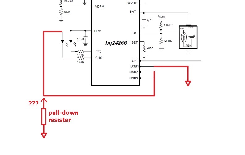

Second, assuming DRV can be connected to IUSB1,2,3 - while Vin=0, can DRV pin hold pins IUSB1,2,3 at 0V or will it be floating?  Should I place pull-down resistors?
