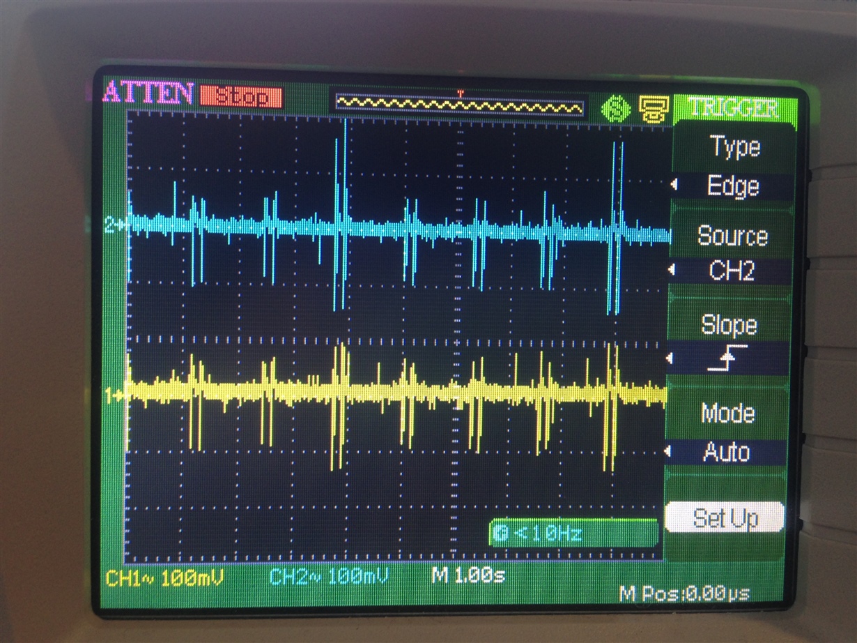

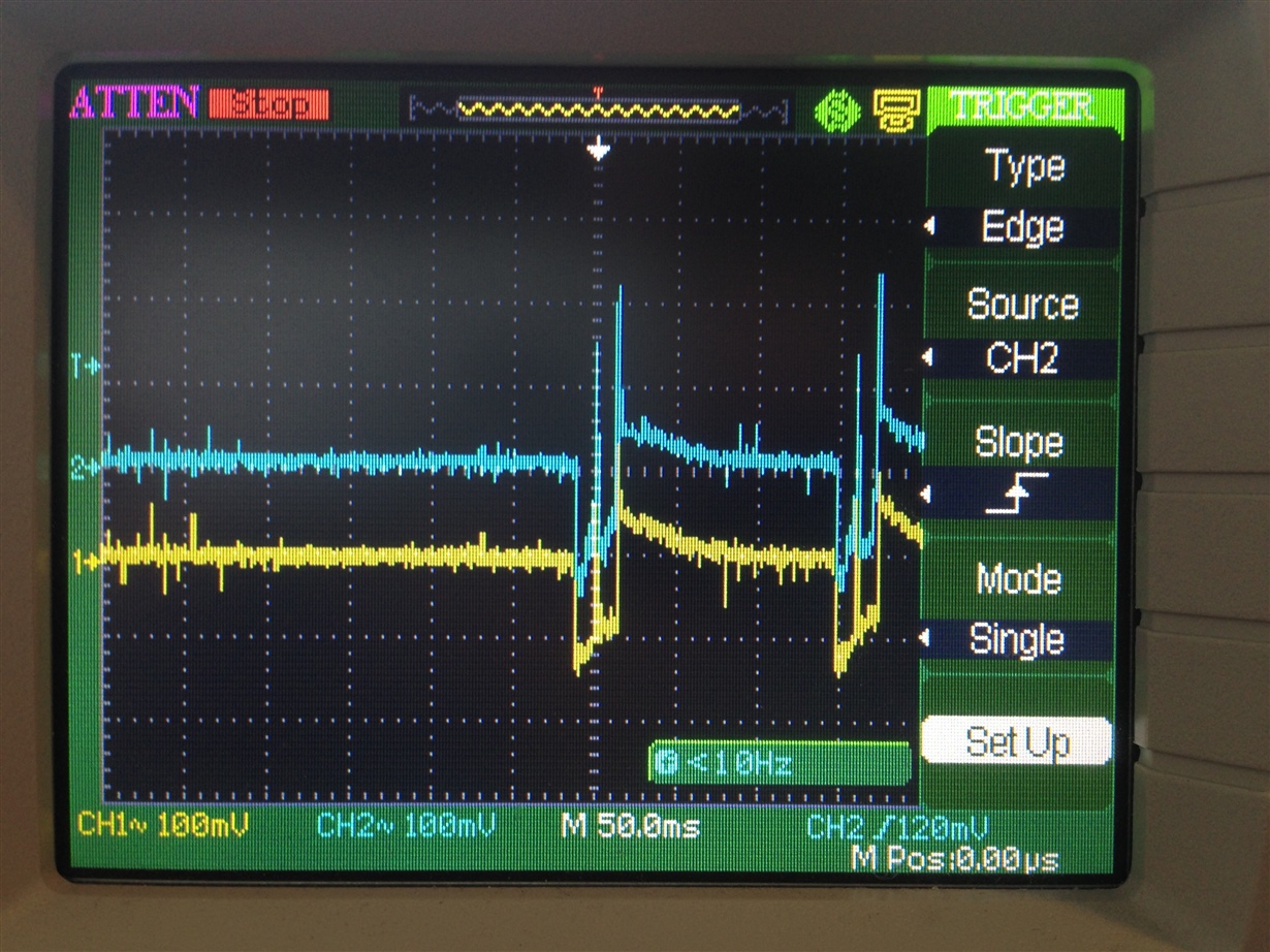

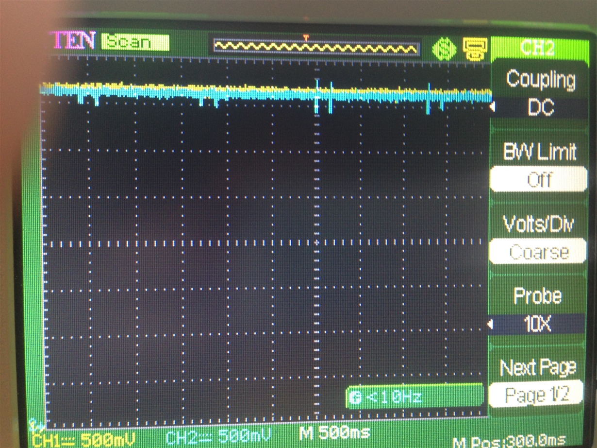

    I've attached three scope images that show the voltages fluctuating when the current drawn from the USB is fluctuation between 43-53mA as described above. This happens when no battery is connected. The blue shows V(SYS) and yellow shows V(BAT). We are currently not using V(IN). They all show same thing but one is using DC coupling to show the voltage levels. We are seeing the same result on V(IN) and V(BAT) and also changing the USB current limit to 1.5A still produced the same results.
  • setting EN_NOBATOP to 1 gets rid of the jitters on the V(BAT) line but it still exists on the V(SYS) and V(IN) lines.

  • Regarding the plots, with a load on BAT instead of SYS, I am not certain what the battery detection routine will do. If you disable termination (which also disables battery detection), what happens? During this time, is the charger switching (i.e. squarish waveform on SW pins)? If the 42mA load were connected to SYS, I would not expect any dip on SYS. I assume V(USB) > VDPM threshold and the VDPM loop has not current limited the buck converter? Is the battery regulation voltage set to 3.6V or 4.2V? Can you measure currents (IN, BAT, SYS) on the scope?
