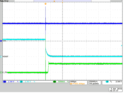

  • Hi Vishal,
    eLoad, resistive load or a simple short doesn't change anything.
    Here is a waveform of Vout/Iout. CH1=Vout, CH2 = Iout (100mV/A). As you can see, the current is not limited to 0.6A as expected but is about 1A

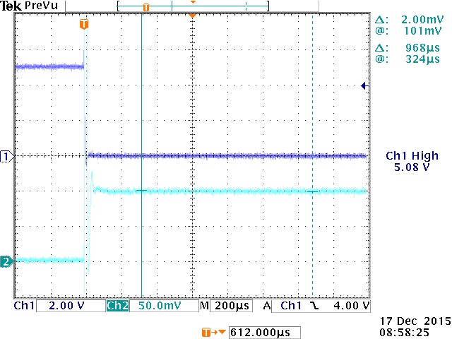

    We apologize for the inconvenience. IMON current is proportional to the load current. With 1V/1A setting, IMON voltage and load current should match with good accuracy.
    Figure 46 shows how fast trip comparator protects the device under hard output short circuit conditions. (Refer to the section 9.3.4 Overload and Short Circuit Protection). Fast trip comparator threshold is set to (1.5 x I(LIM) + 0.375) Amps current level. It is only a coincidence that delta in current you are observing is also 0.375A.
    I have modified the evaluation board TPS25940XEVM-635 to see if I can repeat the issue. With 154k ILIM resistor, current is limited to 0.56A and consistent over input voltage range. See the scope-shot here.
    I would request you to send your schematic and layout for review.  Bad layout can affect any device operation.
