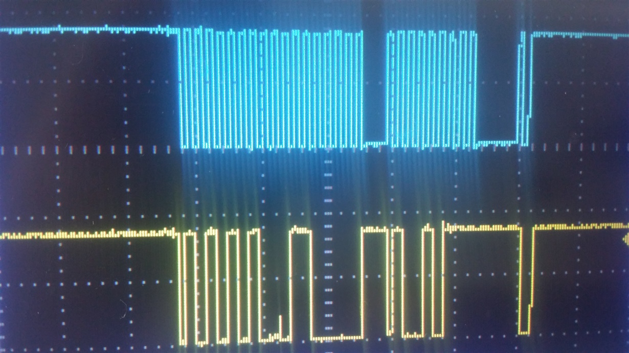

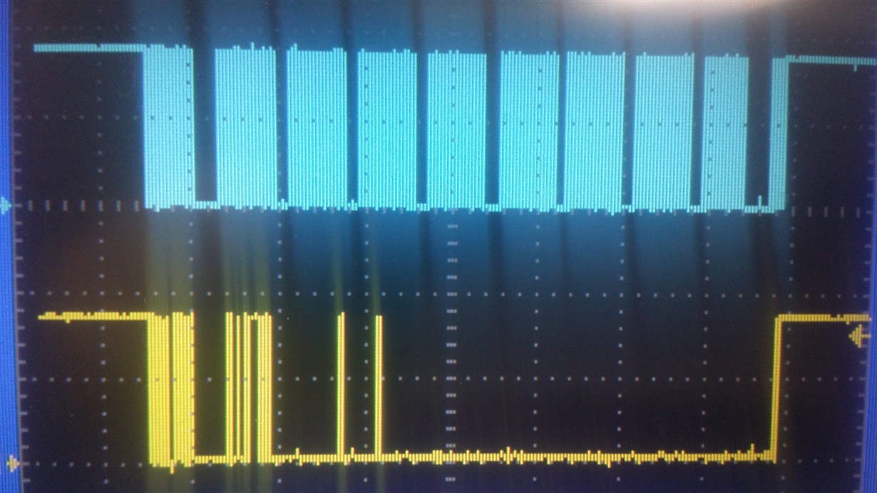

I use STM32F215XX chip communicate with Bq34z110 chip through i2c.
I follow the step in page 28 of slusb55b.pdf
And I follow ,here is the step.
I get different datas from ' step (A) ' , ' step (B) ' , ' step (C) ' , ' step (D) '
Read the ' strp (B) '. I don't read 96 00.
-> I read ' 4C 00  '
Here is the waveform about i2c communication .
< step ( A ) >
-Full
- front
-back
- Value

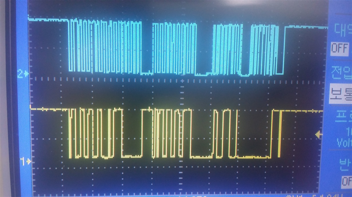

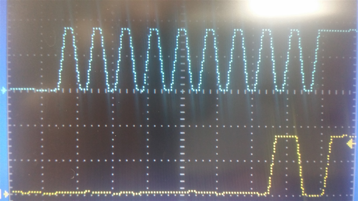

< step ( B ) > : Here is a problem.
- Full
- Value

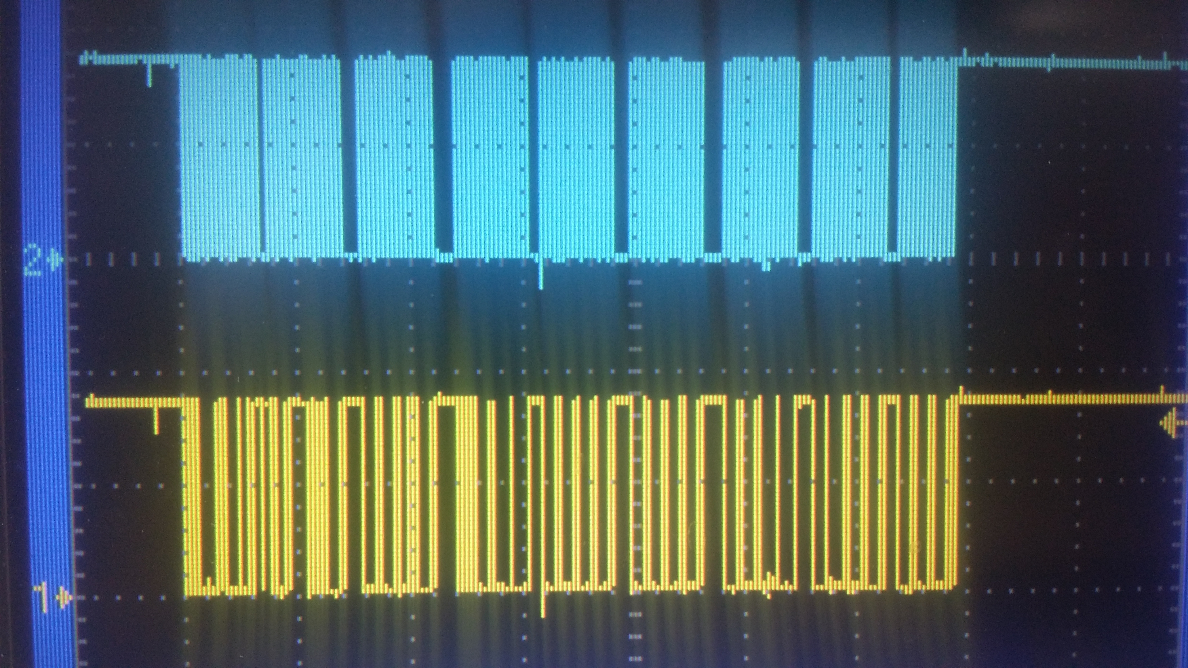

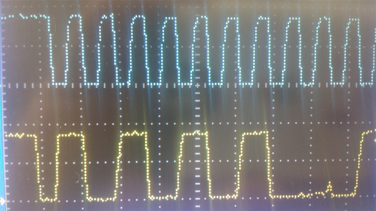

< step ( C ) >
 -Full
 - front
 - back
- Value

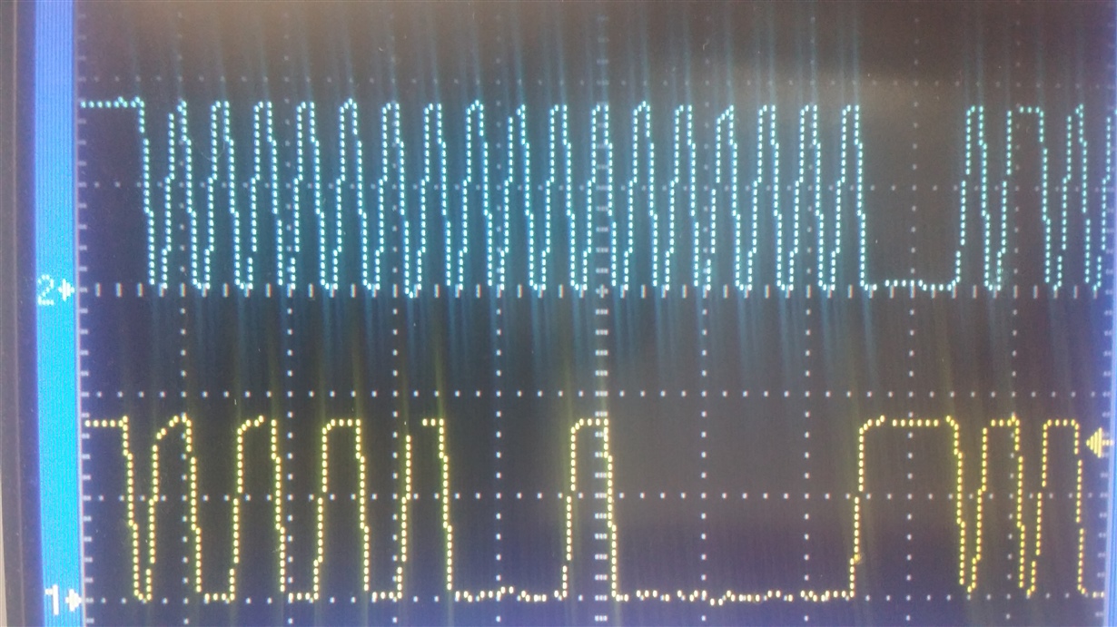

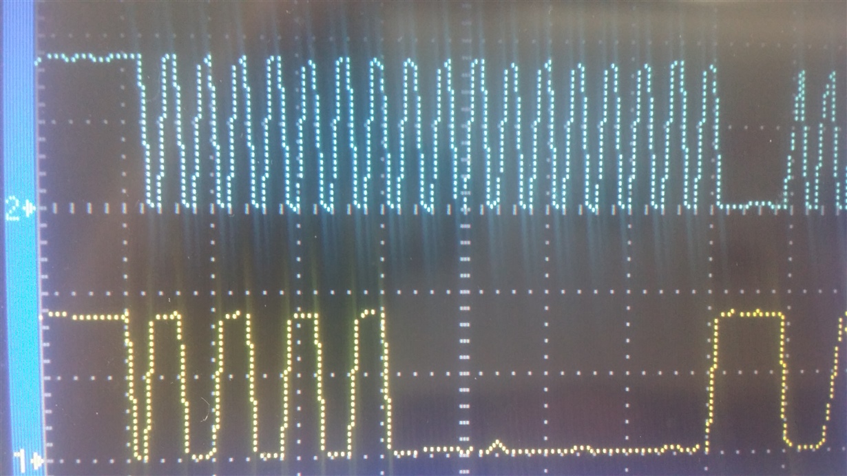

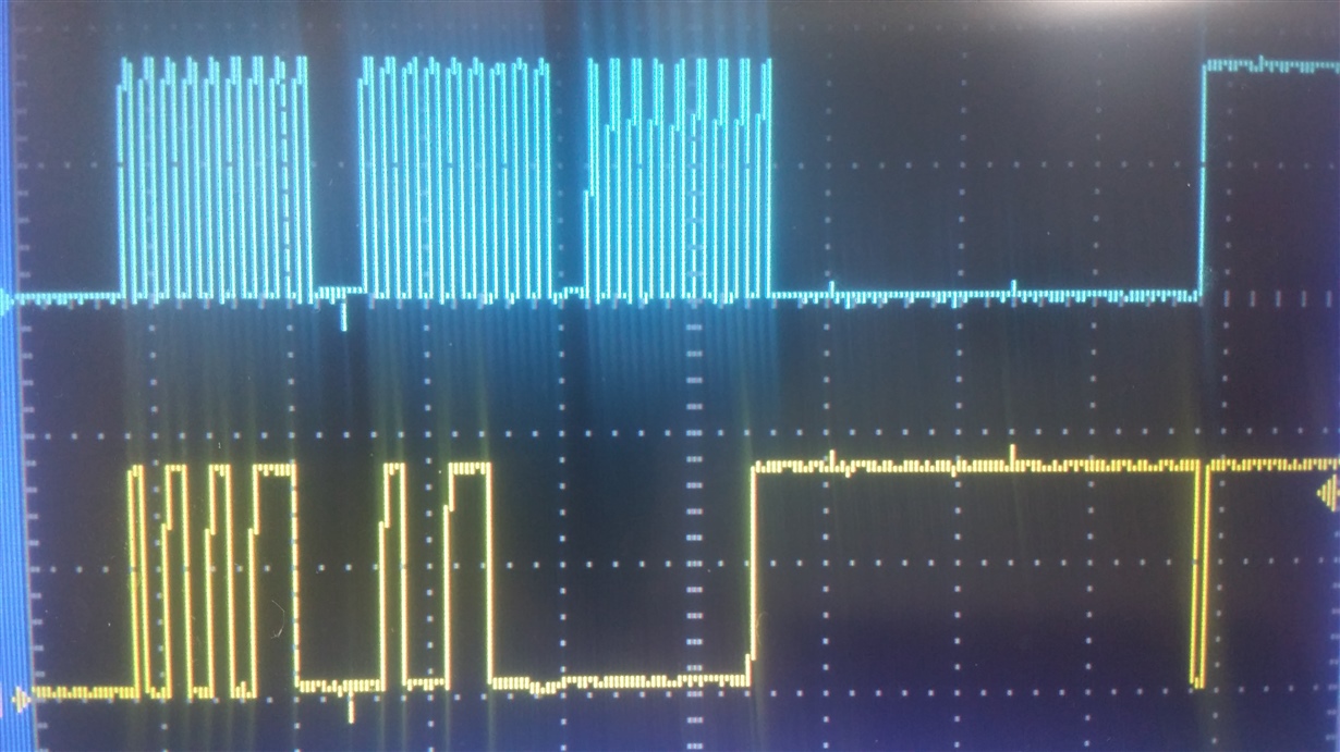

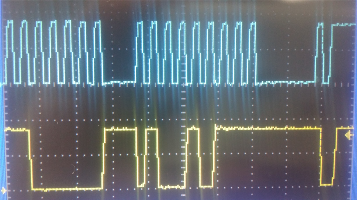

< step ( D ) > :
I was writing. But reading events happened.
NACK!!, in the final.
 -Full
 - front
 -back
- Value

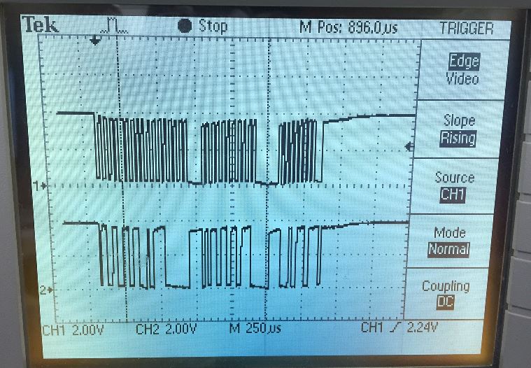

Is there something wrong with my i2c communication ?
' step ( B ) ' .. Is this it?
Regards and Thanks,
user4519591.
  • You may not be using the full command protocol when reading the checksum. The sequence is START; <address with W bit>; <60 command>; <address with R bit>, <data read from the device>;STOP
