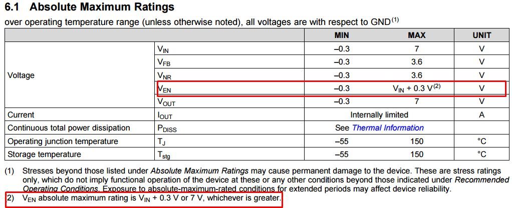

TPS717 / Absolute Maximum Rating of enable pin
Please let me clarify my understanding about abs max of enable pin. "VEN absolute maximum rating is VIN + 0.3 V or 7 V, whichever is greater." means that there is no possibility of damage on enable pin when applying up to 7V on enable pin without VIN (VIN=0V). Is my understanding correct?
In particular, my customer is concerning if 3.3V can be applied on enable pin before VIN.
Sonoki / Japan Disty
    I found the following comment in page 5.
    "(4) Maximum VEN(high) = VIN + 0.3 or 6.5 V, whichever is smaller."
    So I guess that the note 2) of Abs max has typo and it should be "smaller", not greater. Please give your opinion.
    Sonoki
  • Sonoki-san,
    You are correct there is a typo.  Please limit Ven to Vin + 0.3 or 6.5V (whichever is smaller) in order to remain within the operating range of the device.
    Very Respectfully,
    Ryan
  • Hi Ryan,
    Thank you for your response. Please see my comment as below.
    1. Please request to revise datasheet to correct this typo.
    2. I understand that the recommended should be "Vin + 0.3 or 6.5V whichever is smaller" and abs max should be "Vin + 0.3 or 7V whichever is smaller". Is my understanding correct?
