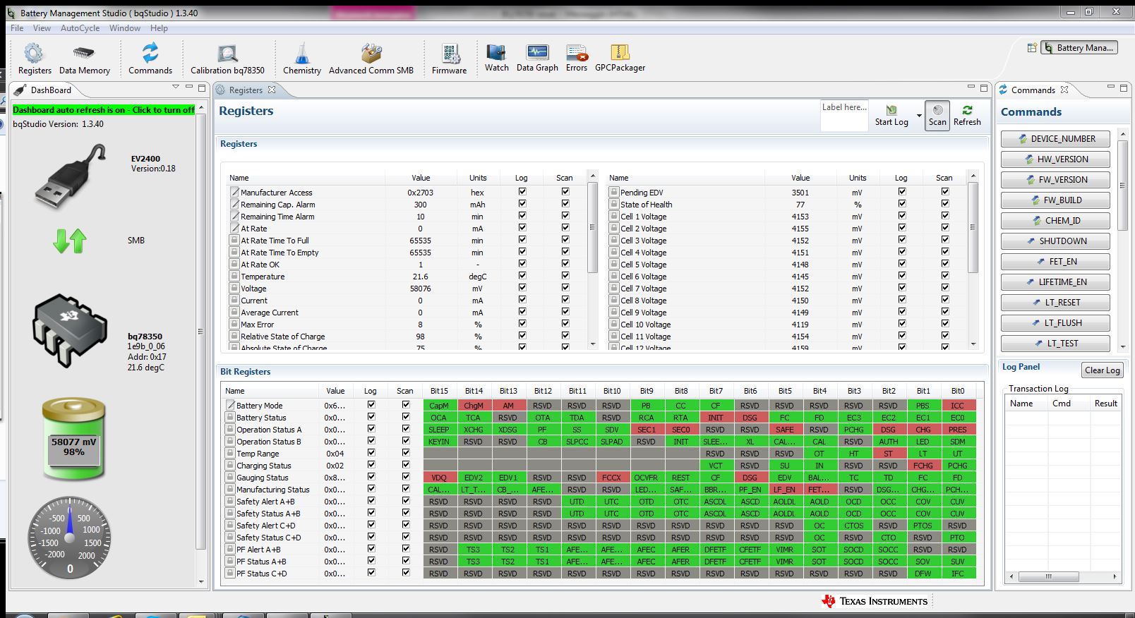

We have design a BMS circuit for a 14S battery pack based on BQ78350-BQ76940 chipset.
After assembling BMS circuits on battery packs in our production line, we experienced several failures (about 1-2% over some hundreds of products). In particular failed systems appear with FETs disabled, but there are no other evidences into registers map about any specific and wanted state (if we compare the registers map of a normal system with a failed one, only CHG and DSG flags into the Operation Status are different). These are two screenshot examples of a failed and normal systems:
Failures was observed into several steps of the battery pack assembly and in particular we found some of them after leaving systems at rest (before testing or also after finishing and sealing operations) or after the overcurrent test (in this latter case only the DSG FET was permanently into the off state, but no overcurrent protection flags were active).
By investigating on this problem we found some potential issues related on the alert pin.
On our board the alert pin is connected between the BQ76940 and BQ78350 by following a quite long path (our board has a particular form factor and it was very difficult to avoid this). A 470k pull-down resistor is connected very close to the BQ76940 pin, while a 1nF capacitor is connected quite close to the BQ73850 pin. During the design phase we used a 470k resistor because the 1M recommended value led to some problems (FETs permanently disabled) and also because a similar value were used into the "typical application" schematic.

Moreover we tried to recreate the failure by forcing a pull up (10k to 2.5V Vcc line) on the alert line, in order to simulate a disturb that can be coupled on such a line. Well, we observed two different reactions:
  1. if the pull-up in applied only for some second or for a few tens of seconds, FETs are only temporary disabled and they are enabled again after few instants after removing the pull up
  2. if the pull-up is applied for several tens of seconds (we don't know exactly the threshold value compared to the previous situation), the system enters into an halted state with FETs disabled and no evidence of any particular state into the registers map (except CHG and DSG flags disabled).
The latter one seems to be exactly the failure we experienced on our products. Unfortunately it is unrealistic on our products the Alert line was intentionally or accidentally pulled up for a so long time. So we would like to ask to any expert:

    So we got to the conclusion that the problem is not related to any external phenomena, but it is only due to any internal behavior of the BQ78350. Its state machine maybe is very sensitive and can stall if some kind of disturbance is detected on the alert line.
    The only possible solution to the problem was to look for any firmware update or fix for the BQ78350. We used the R1 firmware for updating our non-R1 BQ78350 and for the sample with the frequent stall behavior such a problem disappeared (we tried some times to switch back and forth between firmware versions and we obtained always the same result: with the old version we experienced the problem, with the R1 version the problem disappeared).

  • Matteo,
    Thank you for the comments. We have not been able to replicate the problem where the bq78350 does not clear the shorted load fault after it was reported and there were not firmware changes in the -R1 update to address it. The fact that the -R1 firmware seems to have fixed it must be a side effect of another firmware change.
    Do you still have the ALERT pin problem? The ALERT signal was recommended to have approx a 250 us max time constant (500k and .5 nF for example) it sounds like you have twice that so with tolerance the AFE may sometimes see ALERT as high after it is cleared due to slow fall time of the signal and set OVRD_ALERT fault turning off FETs. That AFE behavior can’t be masked. There were a couple of bug fixes in the -R1 firmware with handling and clearing alerts, so one of them may have changed the performance if the issue is no longer present.
