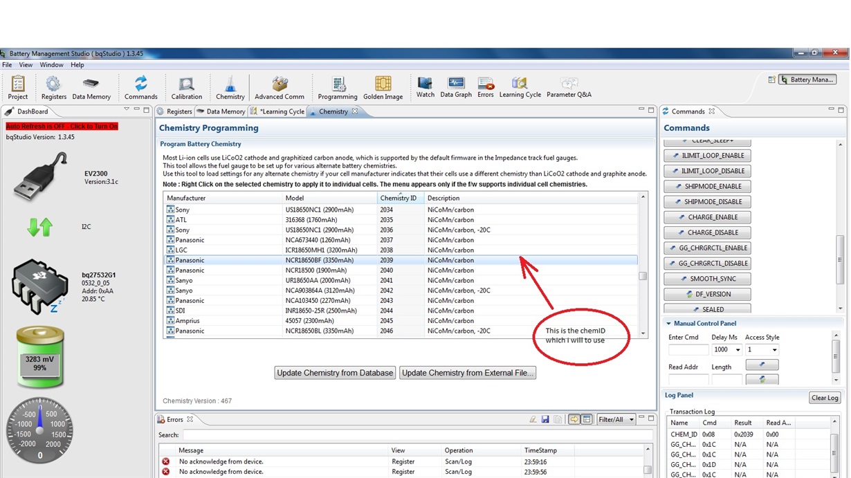

Hi to all,
which are the steps with bqStudio 1.3.45 to programm the ChemID of the used cell?
I found in the chemistry list the dedicated record, but i'm not able with a right click to programm it in the bq27532. The chemistry version is 463.
Another issue is how are the steps to walkthrough when the chemistry database shoud be updated from an external file? I found a .zip file with the version 467. I unzipped it (should i?) and selecting the binaries one by one i was able to update. Unfortunatelly the bqstudio displays further the old version 463. What i'm doing wrong?
Any suggestions are welcome.
Alex

  • Hello Kang,
    thank you for the information. I follow your proposal and indeed the bqstudio recognised the new version of the chemistry database.
    But now which are the steps to programm the chemID from the displayed chemistry list in bqStudio in the bc chip? A right click on the selected record did not allow me to programm it on the bq27532-g1 chip.
    However over the button "Update Chemistry from External File.." i was able (that is my interpretation) to update the database in the chip selecting one file by one from the mentioned directory. If now ,i would change the chemId in DataMemory register then the corresponding Voltage/Impedance values over SOC will be automatically set in the chip? How can I chck the correctness of the data to the corresponding chemID?

  • How can i programm the marked chemID in the bq27532? A right click on the marked data set did not allow me to apply. The fw seems not to support individual cell chemistries. I use the button "Update Chemistry from External File" and  downloaded all the binaries file in bq27532. Is this correct?
    Further, I've set the chemID in the DataMemory in the OCV Tables class (it is correct on this way?) and I was able to perform a learning cycle(bqStudio says it was successfully)  but the value of UPDATE_STATUS0 was not changed from 0x00. Therefore the learning capacity is not correct.

    A very gently employee from ti has given me the correct procedure for updating the Chemistry on the gauge:
    Open bqstudio
    1. Make sure the gauge is not sealed and in full access. Verify the FAS and SS bits are cleared.
    2. Click Chemistry. Select your chemID
    3. Click Update Chemistry from Database. (i issued this several times over an EV2300, due the communication errors)
    4. Go to Data Memory>OCV Tables, verify ChemID, it should have the desired value.
    Note: the Update Chemistry from External File is used when the users has a separate chem file from the ones bqStudio provides.
    Regards Alexandru
