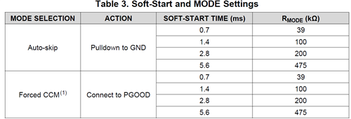

Could you tell me about TPS53353 mode settings.
Customer does not need a SS function.
For that reason,Customer is trying to install a 0Ω resistor.
Can we set up a resistance that has not been written in the data sheet?
In that case,Is it correct in the idea that the soft-start time = 0?
